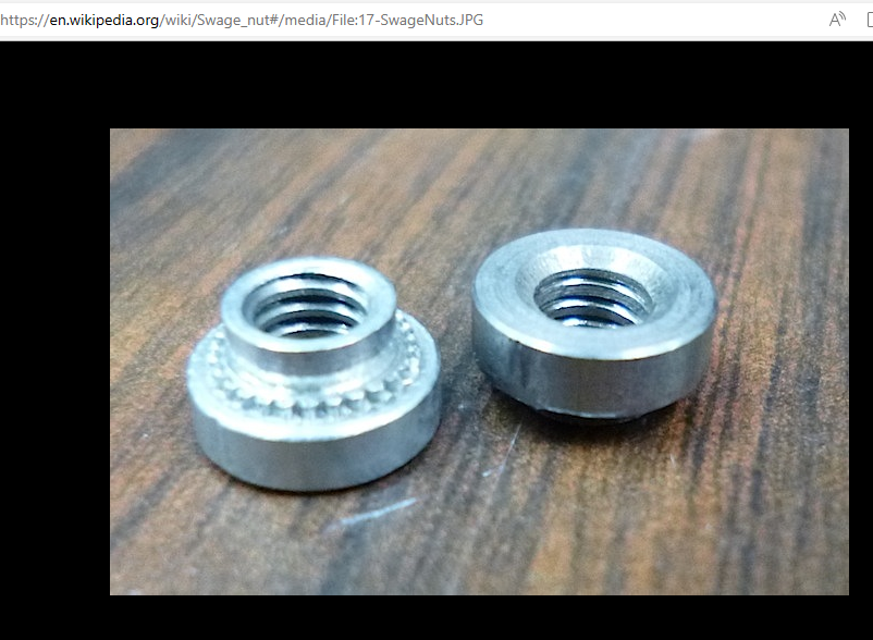

sleek fiero
APR 10, 10:24 PM
No swedge nuts have dimples forced into the sides of the m that cause an interference fit to the bolt threads. Your rocker arm nuts are swedge nuts.
Signupacct
APR 11, 01:12 PM
now that you have used swedge a second time I know it is not a mispell or auto spelling correction error
not finding in a google search
perhaps you can send a link to a supplier
thanks in advance
Joe k
sleek fiero
APR 11, 04:36 PM
Hi Joe; different manufactures' use different terminology but it's an all metal locknut. when they forge the nut they swedge dimples in to it to create a slight interference on the threads to stop the nut from working loose.[This message has been edited by sleek fiero (edited 04-11-2023).]
