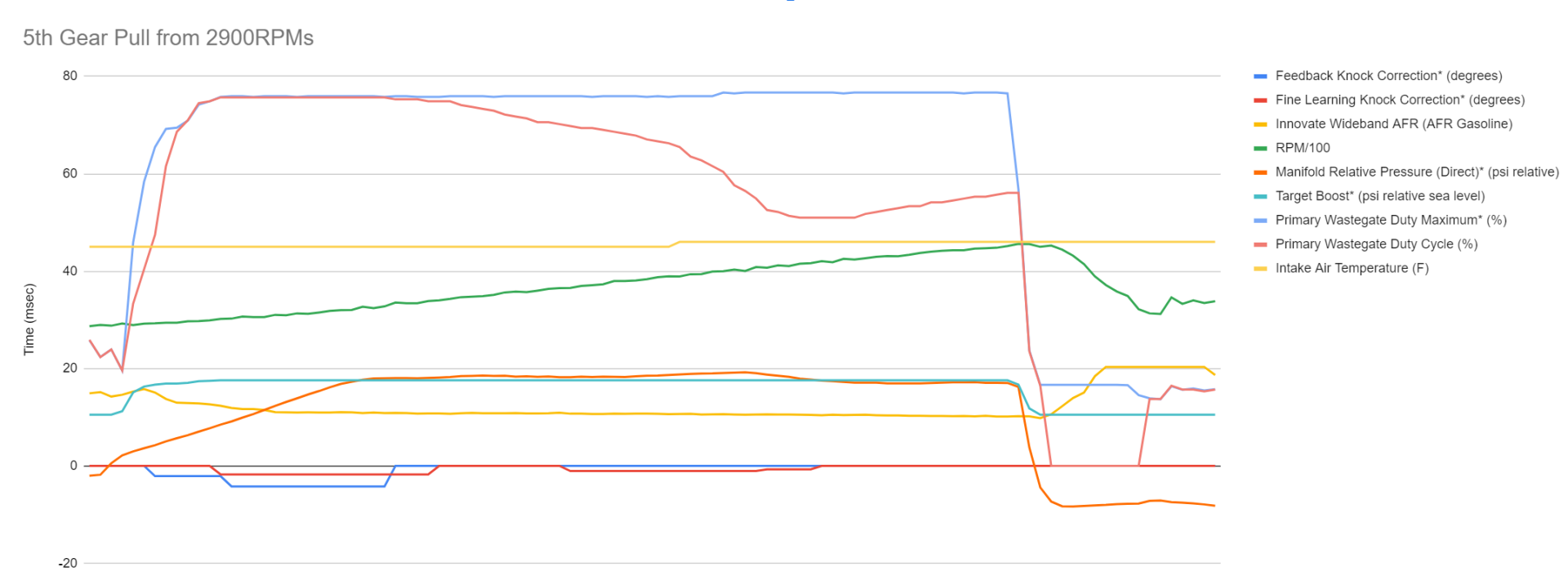

I like to graph my logs in google drive's excel program, I just upload my CSV into there, label my columns, graph it, and it's very easy to select the data you want to graph. You might need to change the RPM scale so that all the other values are not miniscule in comparison, see below I create a new column for RPM which is just RPM/100. Then you can post a screenshot of the graphed data here. Otherwise you will need to host the file somewhere and provide a link to it, and it is up to whoever is looking at it to graph it which might give you less takers.
Here's an example from my WRX:
