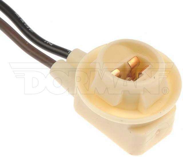

All have the brackets. L side is molded into the fuse box trim. R side is stamp hole in sheet metal.
To hold a "Marker Light" socket then use 168 bulb. Sim to: https://www.dormanproducts.com/p-16574-85868.aspx
To see C209 where the get power & ground... Have to pull the left speaker to look. Get at it to plug whatever is another story.------------------ Dr. Ian Malcolm: Yeah, but your scientists were so preoccupied with whether or not they could, they didn't stop to think if they should. (Jurassic Park)
Son of a...I have no idea how I missed it the last half dozen times I stuck my head down there, but there they are. Shame about the wiring, though.

Many don't know what the holes are until you see the plug that uses the weird shape hole.[This message has been edited by theogre (edited 04-03-2023).]
