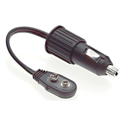

I wonder what the amperage is for that solenoid. I assume milliamps? If so, I would imagine you could use one of the "computer memory saver" adapters:
 [This message has been edited by IMSA GT (edited 12-31-2022).]

Side Note: 9v to lighter plug thing is useless on most newer vehicles because Lighter and Aux plugs are Not connected to "12v" when I-key is Off. 9v battery doesn't have enough power to run the car w/ key On or other positions and may cause problems w/ some things. Example: Many cars still have heater blower On when I-key is On that drains 9v in seconds and heats that as a short circuit if doesn't have a fuse to blow.
