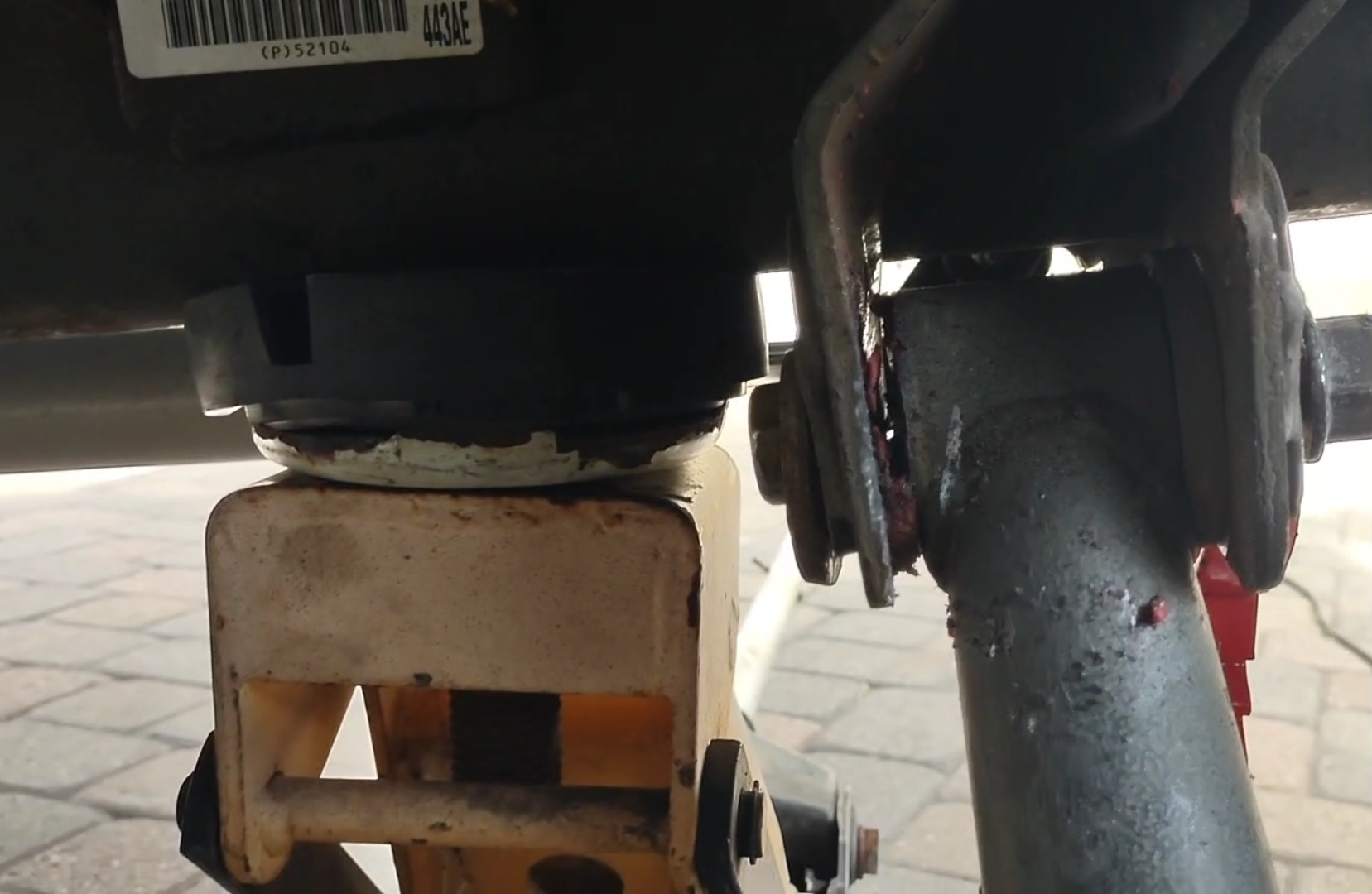

Traditionally, I use a recip saw with a carbide blade to make quick work of bolts that have seized to the bushings.
This is great when you have sufficient room in which to move around, but for those troublesome areas I've been scratching my head as how to cut bolts without damaging the frame around them.
A couple weeks ago, I was talking to my mom's next door neighbor, who's a retired machinist. I floated this by him, and he brought out an air saw.
It was awesome - a recip saw in a tiny package for hard to reach areas.
My big issue is that it is taking forever to cut through. I have already dulled two blades on the bolt I'm cutting on the front suspension, and it took a very long time to get that far. With the bushing in the way, and sandwiched between the frame and the bushing, I'm not even sure how far into the bolt I've cut. I tried a test where I took a blade and cut it on the head of the bolt to see how deeply I could cut in 30 seconds, and got about 1/2 MM. At that rate, I should have cut through this bolt by now.
Which brings me to my question - where can I get diamond or carbide blades for an air saw? I've got all of the bolts on -this- car, plus another Fiero I'm working on.

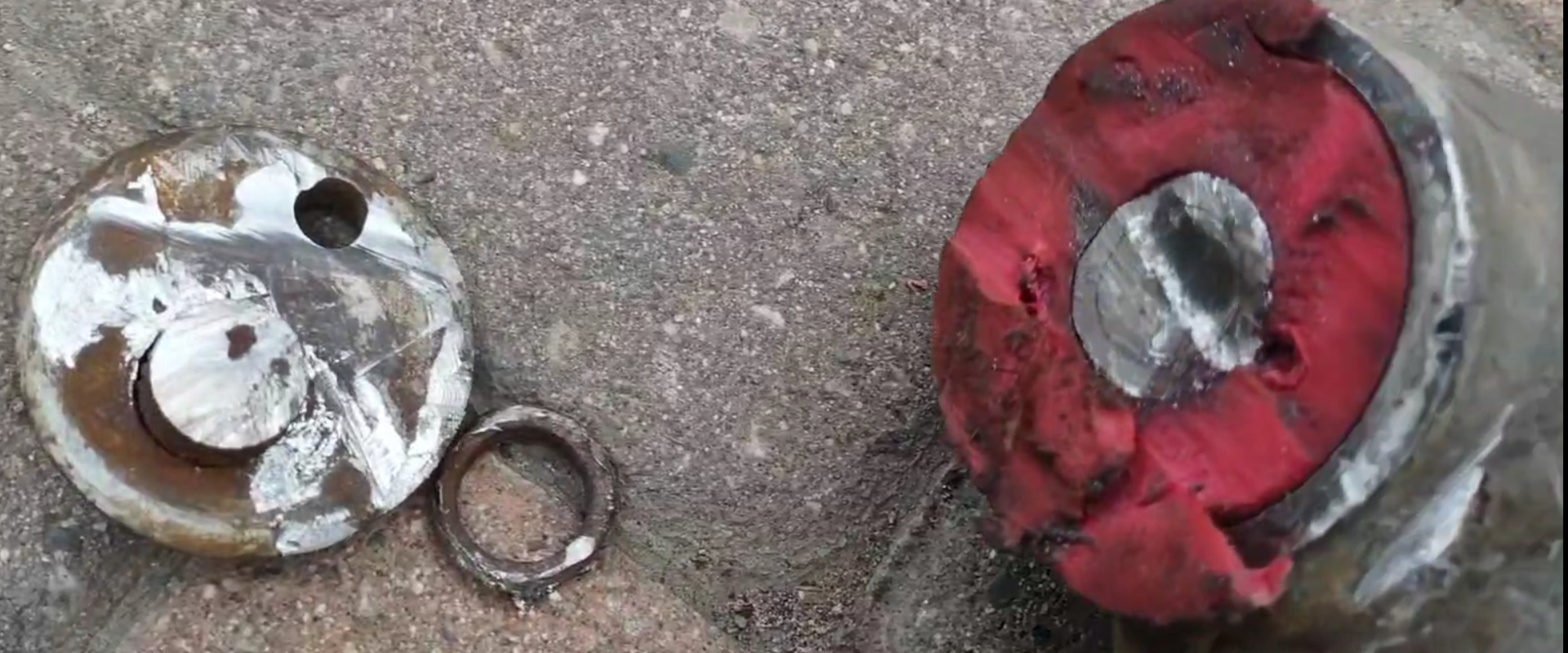

I ran into this same problem a few months ago while working on my Ram's suspension. I used a sawsall with about 3 blades from a variety pack with, I believe, were 8 inch blades I got at HF. I think it was about 10 or 15 bucks. The 10.9 bolt froze to the bushing sleeve. I had to cut through all three, poly bushing, sleeve, and bolt. Maybe the longer blades will work for you too.
I have a reciprocating air saw also and it uses regular jigsaw blades but they were not long enough for the job at hand.

The area in which I'm cutting has no good room for a longer blade, unless my hands were REALLY steady. They're not.
I'm currently working on the front passenger toward the rear. The other bolt I was able to cut with a regular carbide blade on a full size recip saw.

I don't have great access to be able to get a cutoff wheel in there, where the car currently sits. And, the car can not currently move.
