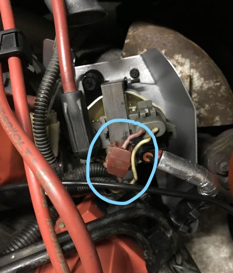

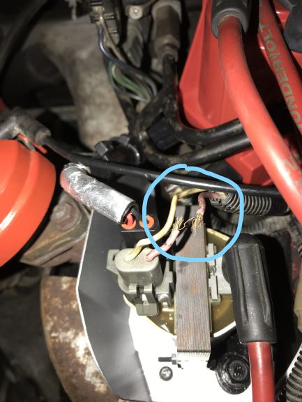

Over the years I have had a similar problem twice. Both were intermittent and it drove me crazy. Once it was a bad positive cable from the battery. It looked fine from the outside but when removed and some of the insulation cut away there was a good amount of corrosion present. Replaced the cable and everything back to normal. The second time it appeared I had a bad ICM. Replaced the module and everything was fine. For several months. It happened again and replaced the module. No problems for over a year then difficulty starting and dying on the road. Weather, heat, cold didn't make a difference. Then I noticed something. There was a tap on one of the wires to the ignition coil. When I tugged on it, it came apart. That was the cause of all my problems. Fixed it and have had no problems since. I am no mechanic, but hope this may help a little.
