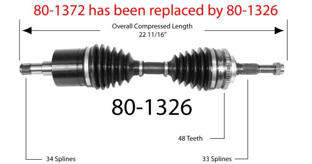

Stock fiero axle was eventually replaced by this one:

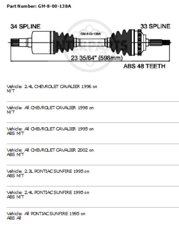

Here is one that is about 1" longer:

La fiera
OCT 10, 11:23 PM
I had the same problem when I switched to the F23. I fixed my problem by using a 2000 Cavalier axle. It uses the Fiero splines in both sides. The only thing you have to do is to remove the ring gear for the ABS.
fieroguru
OCT 11, 06:46 AM
| quote | Originally posted by mcguiver3:
Thanks for the quick reply. Does that longer one have the ends that fit the Fiero hubs/trans? |
Yes. Just knock off the ABS ring.
