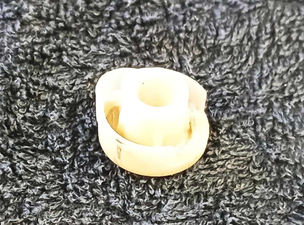

I did find this mystery white plastic thingie on the garage floor after reassembling the door:
