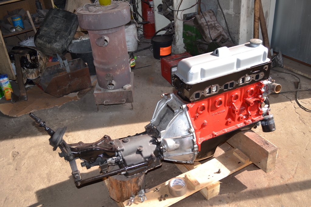

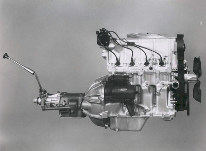

btw.. Opel and Vega engines are different.
My Opel 1.9 is an all cast iron, cam in head engine developed in Germany and was the basis for a lot of 4 or 6 cylinder variants.
The Vega 2.3 is an all aluminum engine that had a disappointing record for longevity

Many Opels Did have same "Vega" Engine w/ same problems... Very likely depends on exact model, trim level and year, even what county is to sell them. Uncle had one of this and love the car but junk it because of the engine.
Is sim to "everyone" says 84 Fiero had same engine.... But 84 Fiero w/ Indy trim may have "later" version w/ roller cam setup making a bit more power just because of different cam grind. Other 84 only have them if recall/warranty replace the factory engine.[This message has been edited by theogre (edited 10-13-2022).]
