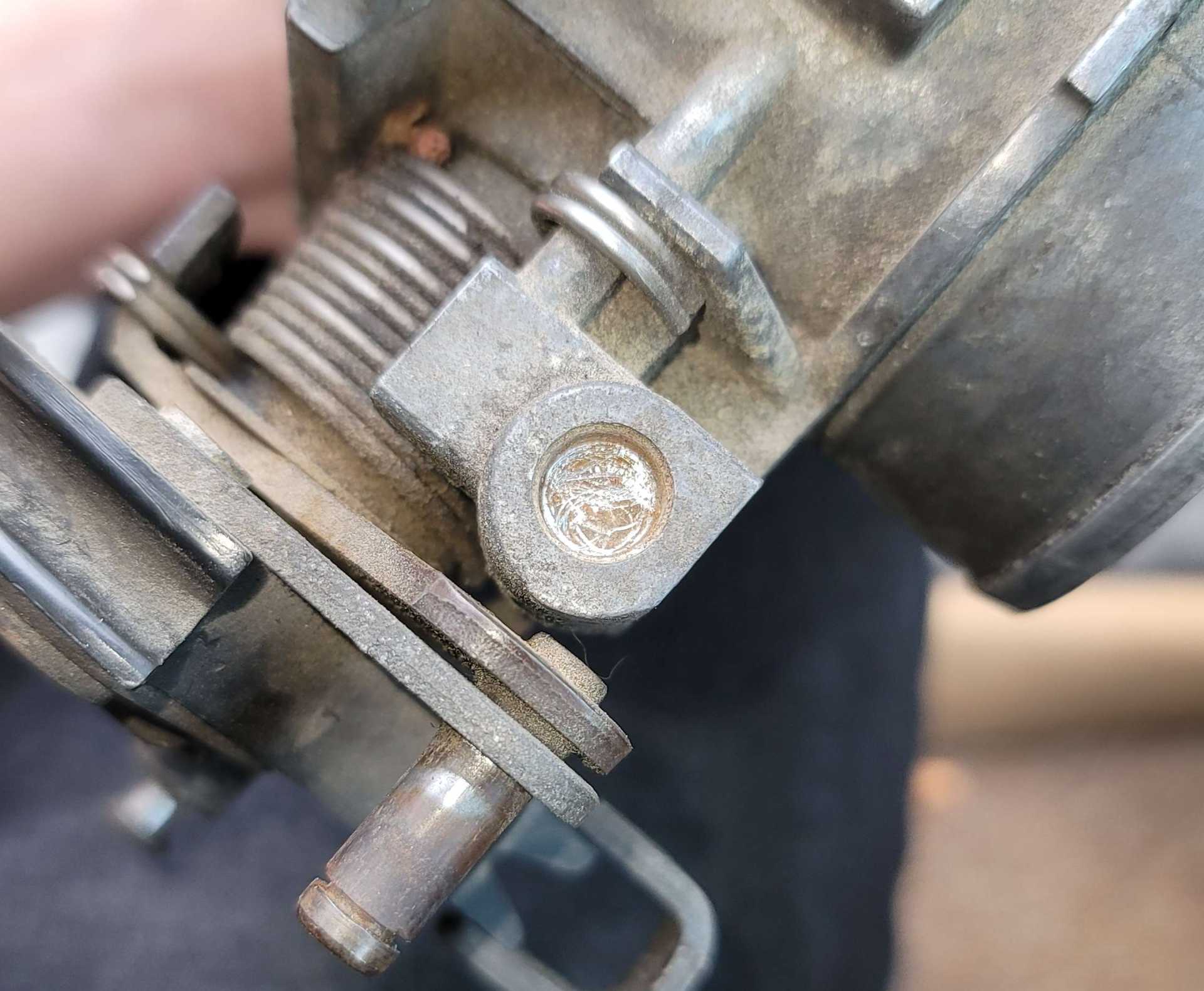

It took me a long time to figure out why this would tell me anything lol. Anyway, it does stall when i cover the TB intake. My idle screw is capped off, and doesnt appear to have ever been messed with though, so i'm not sure where to go from here...
 (its all scraped up from me trying to see if it seemed factory)[This message has been edited by A_Lonely_Potato (edited 10-05-2022).]

| quote | Originally posted by A_Lonely_Potato:
That makes two of us.
If the engine stalls when the entire TB is covered, that would seem to indicate that there are no vacuum leaks beyond the TB. But if just the IAC port is covered, and the engine remains idling at 1200 rpm, that would seem to indicate that the butterfly valve is open too far... which is usually the result of someone messing with the factory-set idle stop screw. But you say the plug covering the screw head is still in place. I suppose it is possible that someone could've reinstalled a plug after changing the idle stop setting, but that doesn't seem too likely.
Does there appear to be excessive play in the butterfly valve shaft? The air's got to be getting in somewhere![This message has been edited by Patrick (edited 10-05-2022).]
