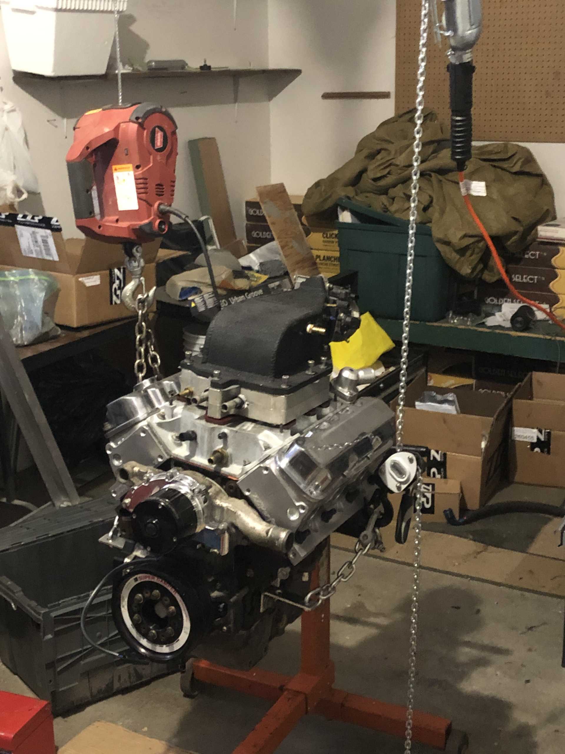

There are a few videos showing where to remove material, discussions etc. I don’t have any links but it just opens up any air restriction. I’m not sure if you’ll need to modify the decklid to fit 2-1/2” ? My LIM was ported by someone else. After you get rid of your pulley it should look something like  [This message has been edited by rourke_87_T-Top (edited 09-22-2022).]

I have a Series III N/A block with a Gen III blower, full stack ZZP intercooler, Northstar TB
Recently purchased a brand new Gen V blower, full stack ZZP IC for it, new gasket kit, new TB adapter plate, fasteners, and Series III LIM.
