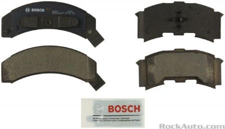

Got new Bosch all ceramic Camaro pads (Archie front calipers are 82-89 Camaro), cleaned everything thoroughly and lubricated. Everything was great for about 2 weeks, total silence and no vibration/shakey ride. Even mpg improved by 2 for my daily 1hr commute, but the clanking is starting to come back (but not so high pitched yet) along with the slight vibration/shakey ride. No squeaking though.

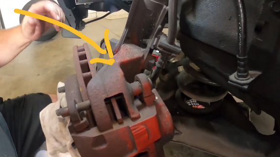

While I was installing the new pads I watched a few Camero videos on YouTube and followed those. Those outer pads sit loosely on the caliper and have to be held in place when you slip the caliper onto the rotors. Also, In the videos, the Camero has another piece of hardware that looks like it connects to the knuckle up top to stabilize the calipers:

- Or do I need to bend the metal tabs on the pads to get them to pinch/hold tightly on the calipers?
Original Fiero front caliper pads have tabs to hold onto caliper:
