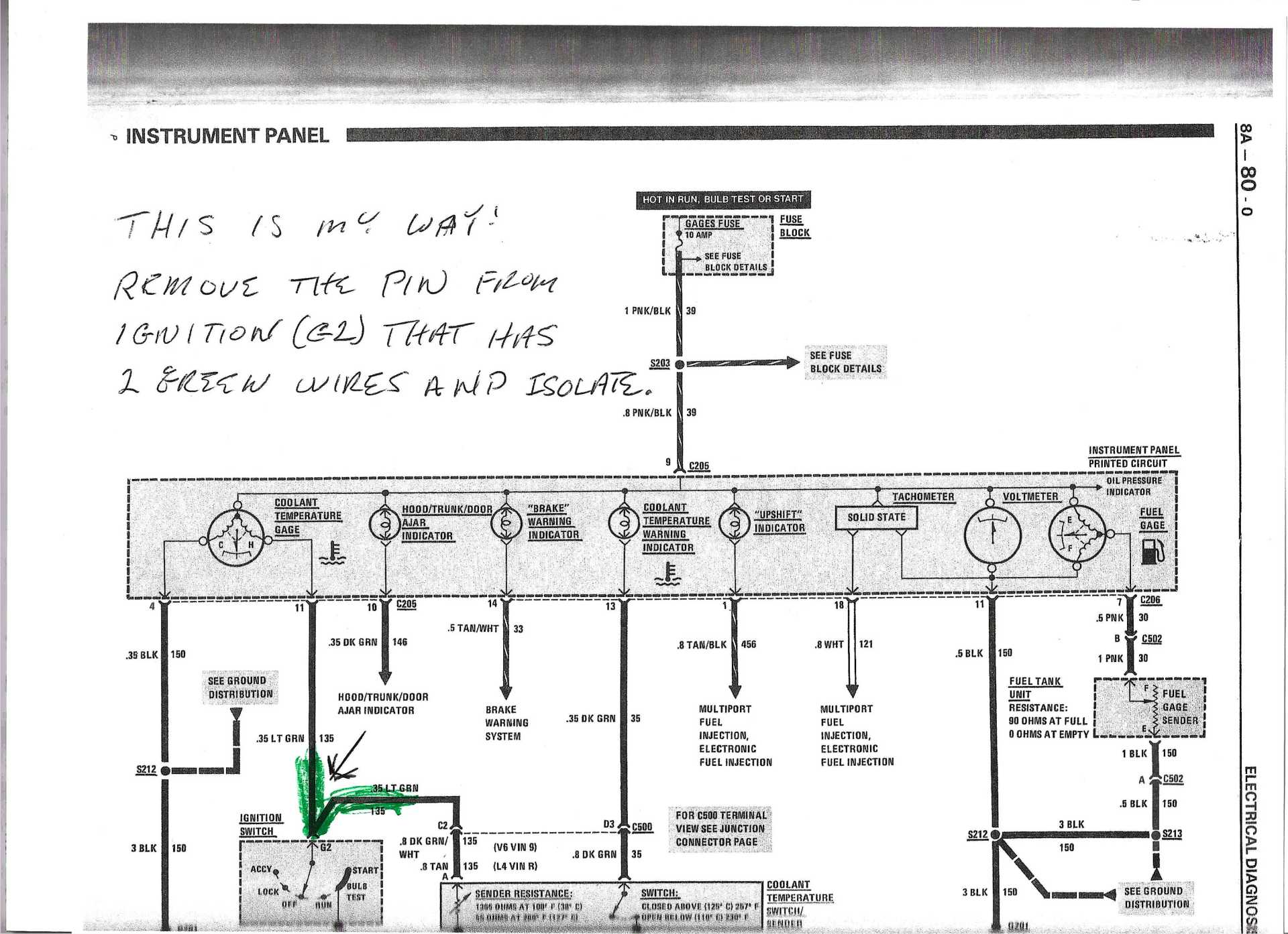

The gage can be kept from pegging by simply disconnecting the circuit from the ignition switch on top of the steering column.
One of the terminals has two light green small gage wires. Disconnect and insulate the terminal on the wires and you have prevented the gage from pegging.
If you want the HOT lamp to illuminate at KEY ON, run a jumper from the HOT lamp wire to the terminal on the ignition switch where the above wires were attached.
J Gunsett
SEP 03, 10:30 AM
Do it the easy way and pull the 2 green wires at G2 in the ignition switch located on the steering column.
