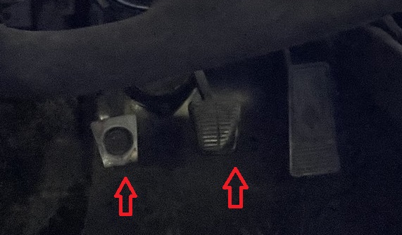

Your foot? (i.e. after repeatedly slipping off the Clutch and the Brake pedals.)
 [This message has been edited by Notorio (edited 09-01-2022).]
