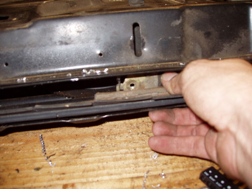

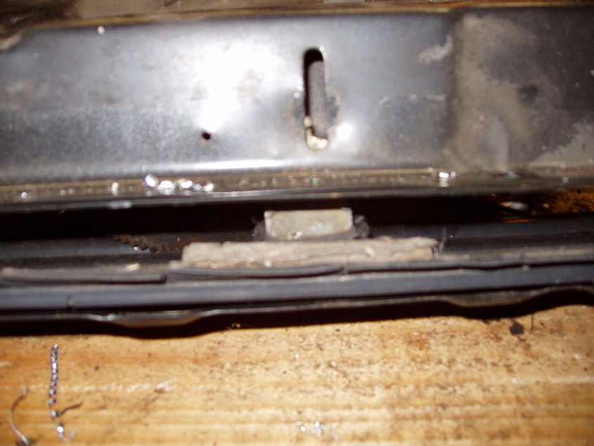

1988 GT. I have the driver side door inner panel and outer skin off while replacing the dew wipes. I can clearly see the two inner pads with their slide adjustment, but I don't see how to replace them. The "body" which curves into each pad is under the metal top and inside of the door frame. The 10mm hex head screw passes down through the top of the door frame in into the thread "body". I can't feel any way to reach inside.

I just checked. My window glass is still in the door. With glass up I can get a grip on the inner pads and move them out a little but there's not enough room to rotate them free. With glass down I definitely can't. Restated: taking out the window glass appears to be a requirement for removing the old and installing new inner pads. During these attempts one pad and adjustable metal pad holder dropped down inside the-forget-about-it upper door. I was able to retrieve it with a coat hanger, move it back into place, and now have both probably original inner pads in their positions loosely held by their 10mm hex head screws. Neither of the current inner pads looked bad enough to require replacing so I won't. Not worth the trouble of taking out the glass. The outer dew wipe was easier and those were the pads which were scraping the glass. [This message has been edited by John W. Tilford (edited 09-01-2022).]
