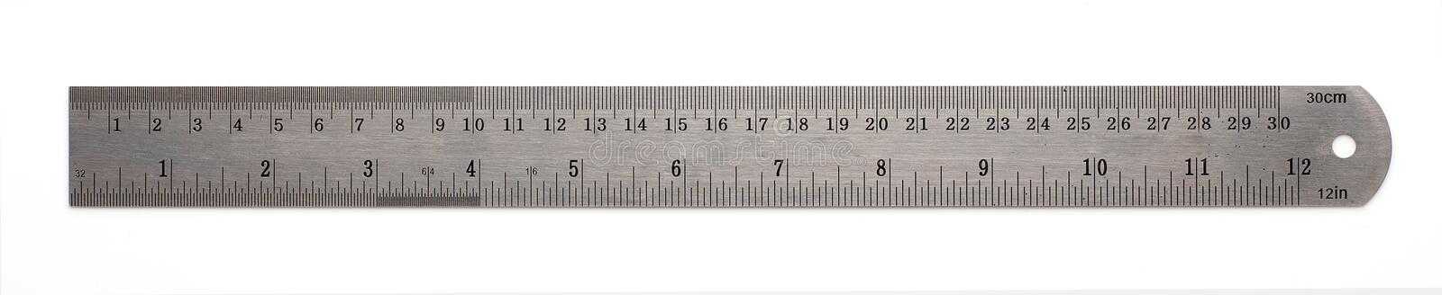

How much travel is your arm doing?
eee33
SEP 01, 07:54 PM
What is a good way to test that?
