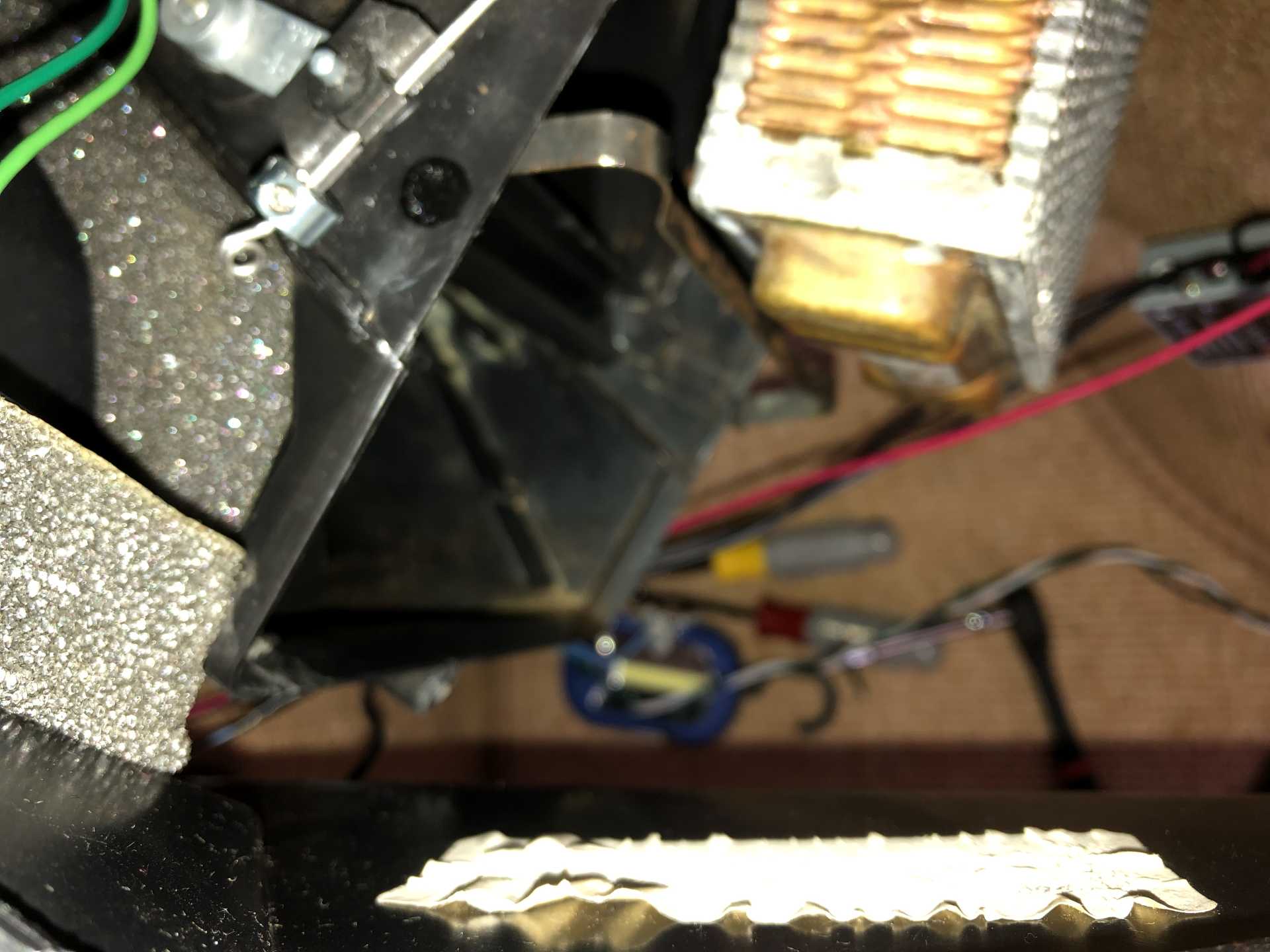

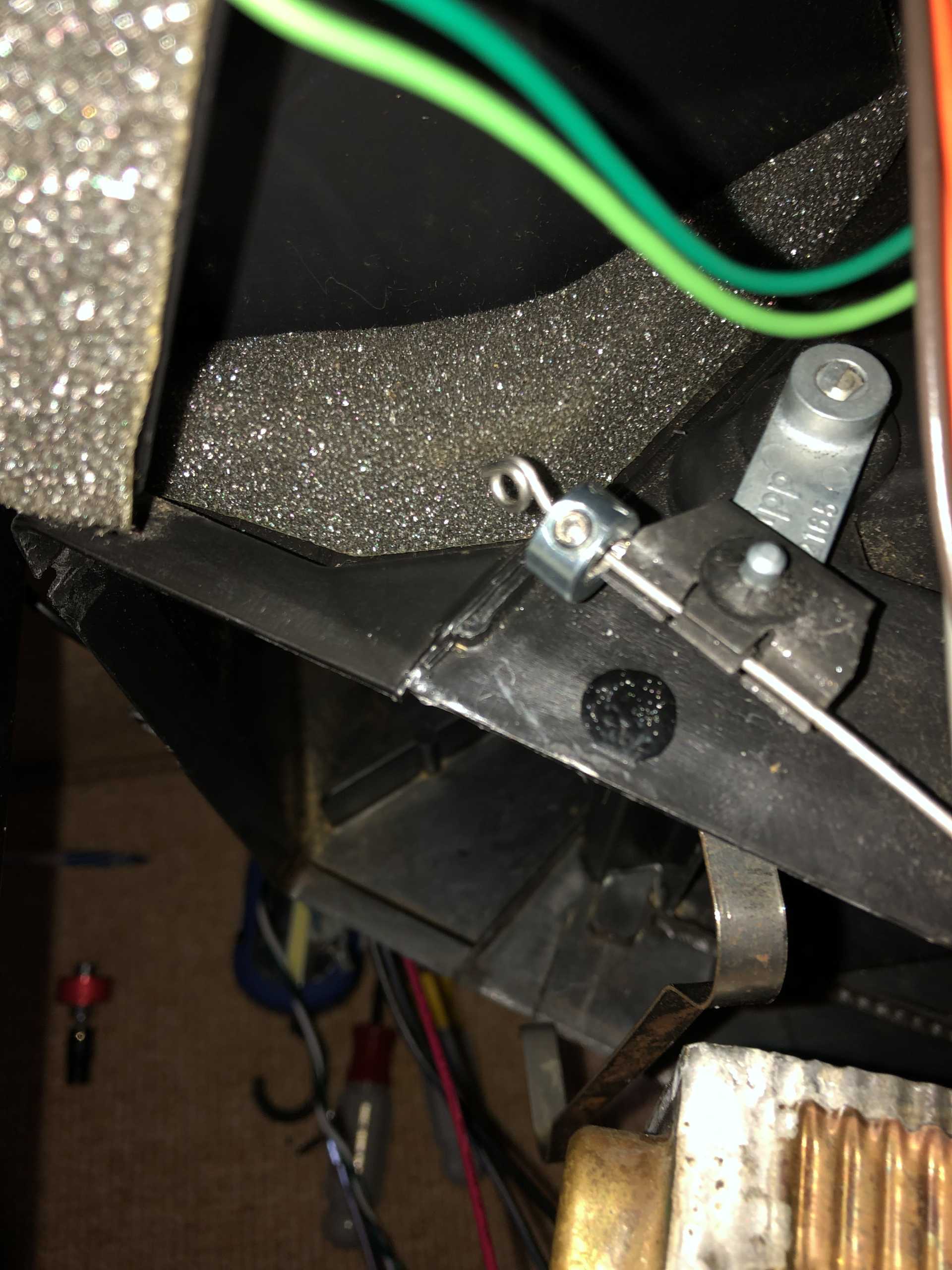

I took my 88 GT to a very reputable AC repair shop that is well known for repairing vintage cars. They discovered that two of the fittings were leaking and that the blend door (hot/cold) was not closing completely. Since I had just replaced the heater core, they felt that the problem was caused by me. I had to remove the bass speaker to get to the heater core, then removed the plastic cover. It was easy to see that the blend door was not closing all the way when the lever was slid to the “Cold” position. I found the problem was that a small plastic clip was not holding the blend cable taught enough thereby keeping the blend door from closing completely. I ended up adding a small metal ring collar to the cable which acts as a spacer so that the blend door closes completely. I wonder if you are having the same problem? The shop must have seen that my AC was getting cold enough, but the heat from the heater core was making the cold air … warmer. You know our cars don’t have a valve to shut off the hot water going to the heater core when running the AC?
Eliredandblack
JUL 29, 02:47 AM
Here are a few pictures of the blend door cable with the added collar that make the door close completely.
