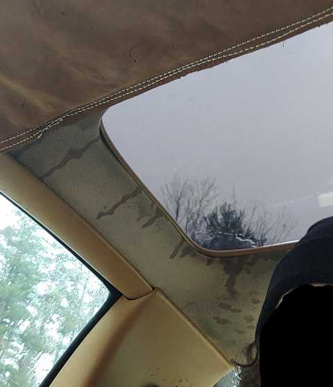

The second leak comes from the moon roof. Ever since I changed out the moon roof hardware ; Seems I could never get a good seal.

If the drain holes aren't plugged, then water won't leak into the cabin even with the roof open.

I'd recommend that you remove the panel completely and check the drain holes in each corner. I have three Fieros with sunroofs, none of which leak. I can drive them in the pouring rain (which occurs a lot here) with the roof panel raised (or closed), and water does not enter the cabin.
I guess the point I'm making is that the rubber seal against the glass is not what keeps the water out.

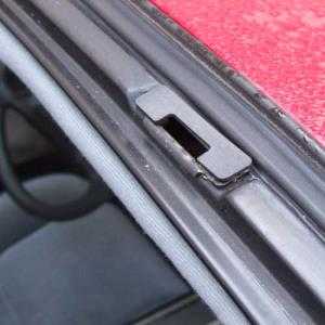

Do you have the two plastic tabs/bushings in place?
i have one on my drivers side. passenger side does not have the plastic. are the drain holes underneath the rubber gasket? mine is adhered down pretty good and i dont want to rip it
Well, that's no doubt contributing to your roof panel being cocked off a bit and not closing quite right.
