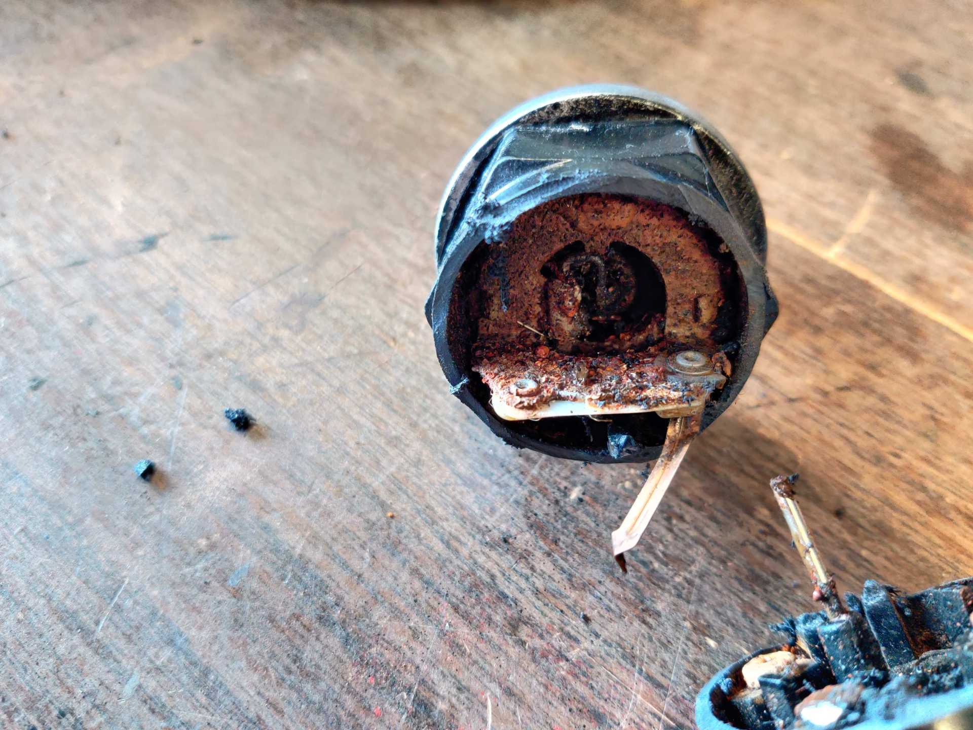

greenturnedblue
JUN 01, 08:09 PM
If its the original sender its probably toast by now. This was mine that I replaced two weeks ago, it was causing similar issues
Rhodesia1977
JUN 02, 06:38 AM
| quote | Originally posted by greenturnedblue:
If its the original sender its probably toast by now. This was mine that I replaced two weeks ago, it was causing similar issues  |
Thanks for the reply and pic. I am trying to figure out how to remove that sender. There is nothing in my Haynes repair book about it. Was it difficult to remove ? How did you do it? Thanks for your time.
JUN 02, 02:18 PM
Look at side for old type. Small wrench fits the nose. I think 9/16" (Somethings Are Not Metric.)
If have AC and Sender on top of engine, Should use second wrench etc to hold the "box" so don't wreck the tube even tho is "bolted down" to engine.
V6 AC can rot like above because pins at top lets "water" inside. Even 88 sender installed this way can have same problem because new Metricpack plug is better "Weather Resistant" but not "Water Proof." Is why TSB to relocate it.
Many failures for old type is leaking diaphragm while rest still "works." Other times FP switch "burns" or OP resistor wears out.
When FP switch or relay burns... often other things are problems making it burn. See my Cave, Electric Motors[This message has been edited by theogre (edited 06-02-2022).]
