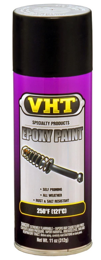

Ah, I misunderstood. Usually when I hear people need to repaint the wheel, I assume just the hub. You're removing all the material down to bare steel for the entire wheel? You can use something very durable like VHT satin black epoxy paint. It should be available at auto parts store or online.
