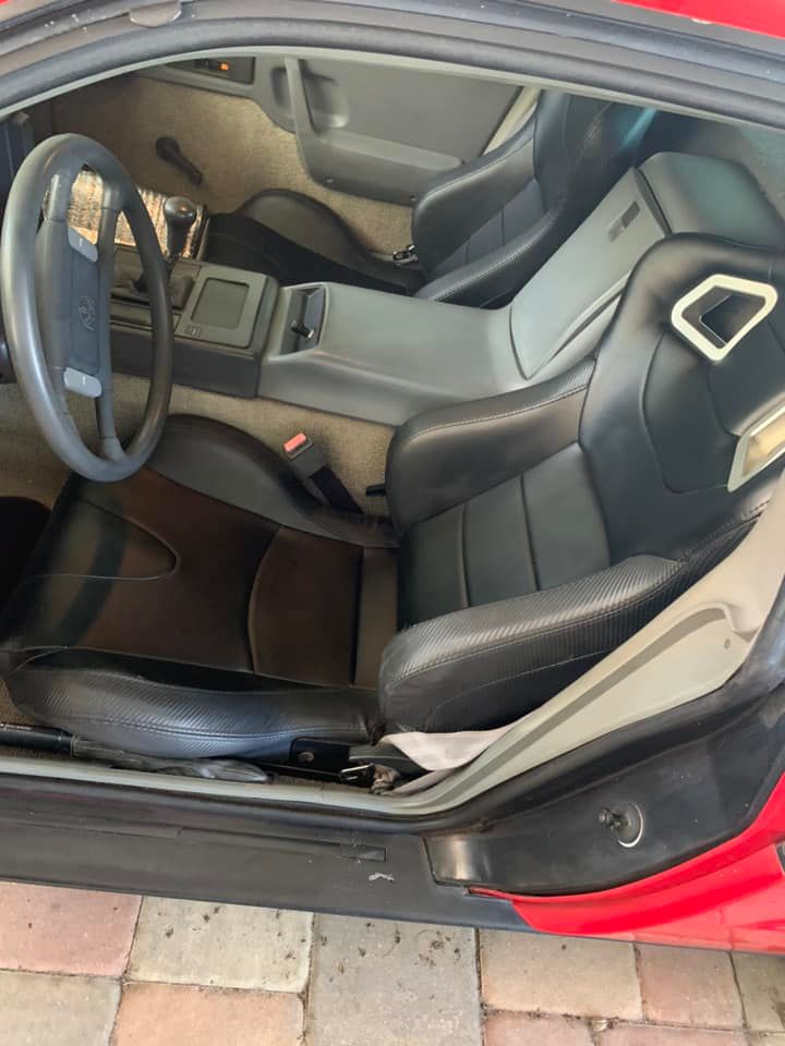

I saw these seats posted recently, I think on face book somewhere. I asked, but did not get an answer, as to what these were. Anyone know? They look very much like the SRT4 Neon style seats. But SRT4 seats bring a lot of dollars, and are getting older now. The one in the picture looks like a new aftermarket type. There have been several seat swaps done. This would be a good place to post them, and where they came from, for other owners to consider.

To change seats in a Fiero requires a width no wider than 19" Anything wider like Corvette, Camaro, Firebird seats will end up being a very snug fit.That is why most Fiero owners just reupholster. This doesn't mean that there aren't other seats for a direct fit but finding nicer ones may be hard. ------------------ " THE BLACK PARALYZER" -87GT 3800SC Series III engine, custom ZZP /Frozen Boost Intercooler setup, 3.4" Pulley, Northstar TB, LS1 MAF, 3" Spintech/Hedman Exhaust, P-log Manifold, Autolite 104's, MSD wires, Custom CAI, 4T65eHD w. custom axles, Champion Radiator, S10 Brake Booster, HP Tuners VCM Suite. "THE COLUSSUS" 87GT - ALL OUT 3.4L Turbocharged engine, Garrett Hybrid Turbo, MSD ign., modified TH125H " ON THE LOOSE WITHOUT THE JUICE "

For the taller guys some of the aftermarket seats can get you very close to the roof as well. But otherwise I usually find most of the aftermarket choices to be a nice upgrade, especially if you do some casual auto-x events or like a 'spirited' run through the rural twisty roads. A fella in Minnesota had some Corbeau seats in his '85 GT and I went for an hour ride with him and was really impressed with all the support it offers between the bolsters etc.

But after I make some more interior changes, and slowly go black on the interior, the seats in the first post are now high on my list. Those are the ones on Amazon. Good to know they can fit. And for what people want for SRT4 seats that need reupholster, I would rather go this route. Seat belts will need to be re devised for the pass through, but its all fun, right? ( ideas there would be appreciated ) Mike's Upolstery also cranks out some excellent work. But I was really more interested to see more modern, performance seats that work listed here. Below are the covers I just put on from RW Upolstery, the F8's.
