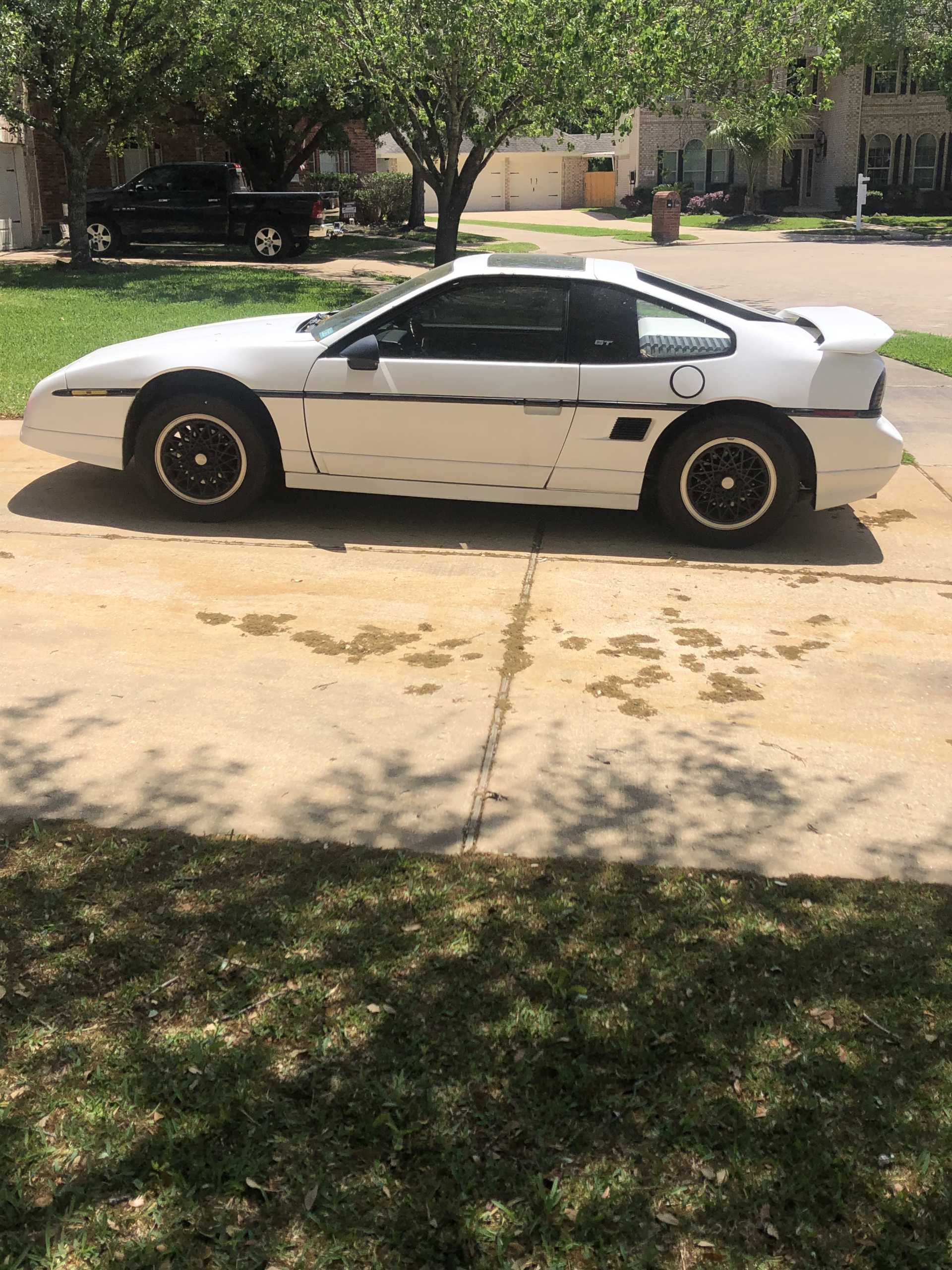

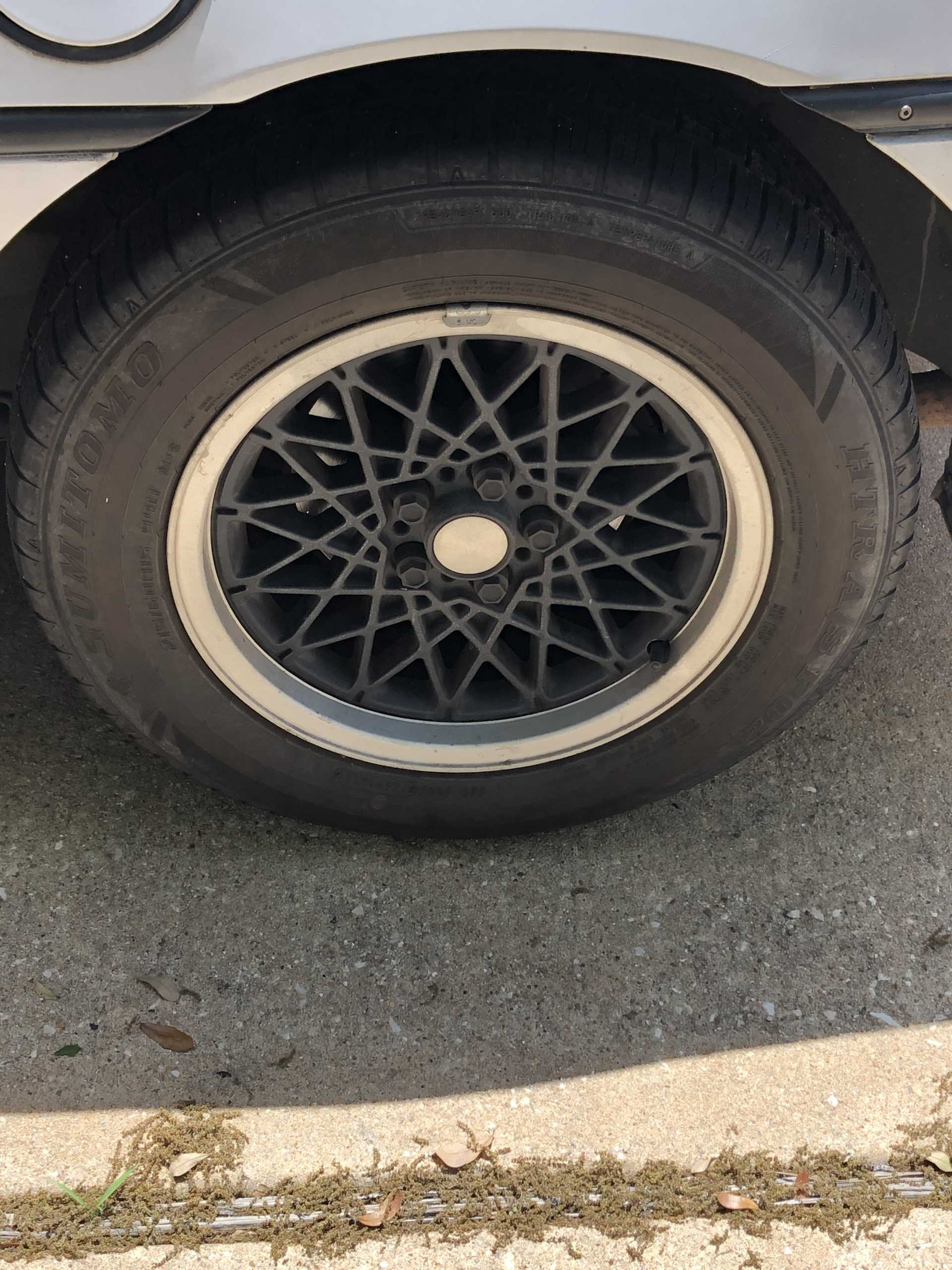

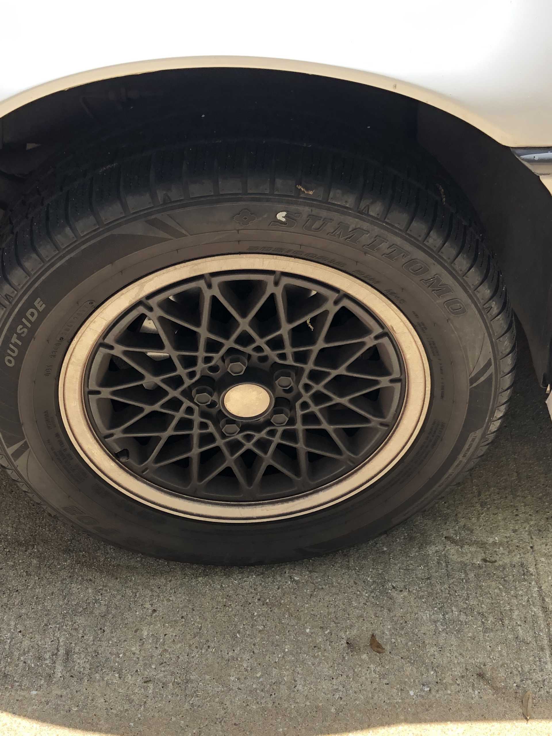

1988 GT She just sits too low in the back and often bottoms out in the rear. I don’t wanna throw parts at her as I have never done suspension work.  Front

If it bottoms out, I would recommend new struts in the rear.
The ride height looks good in the rear.
The 88's do sit an inch higher in the front from the factory.
How long has it been since new shocks were installed in the front?
It is uncommon for springs to wear out on these cars.

Weird...ok. My 86 is higher in the back and lower in the front. Looks a lot better visually. Last time I had an alignment done the guy said the struts looked good and had recently been replaced but the shocks looked old. Maybe he had it reversed though. We have only had the 88 for 3-4 years. She is my daily.....there is no paperwork in the car showing any suspension work being done.....On the back though I did notice poly bushings so someone did something at some point.

Hey, your GT is a twin of mine! 88GT, silver, w/sunroof, stock black wheels.
One of the results of the 88s having completely redesigned front and rear suspension is that the front sits about 1" higher than the rear - normally.
I hated that (seems many do) so there are a few ways to lower the front - cut front springs, find lowering spindles, or what I did - install Rodney Dickman's 1" taller lower ball joints (he also has 1/2" drop ones). The stock wheels fit with these installed, they drop the nose, and they're quality parts. I've had mine for 5 years and they work. They did not have any adverse effect on driving, cornering, etc. that I could detect in my street-only (but often spirited) driving. I highly recommend tham, and they are the quickest/easiest way to level out an otherwise srock 88.

She is white but yeah I just love the stock rims. I thought about getting different ones to open up more options regarding tires but I really just like how the stock ones look. If I have time this evening Ill pop off those wheels and try to get some decent pics of what is going on under there.

His ride height in the rear looks to be fine.
He mentioned bottoming out, so new struts seem to be the first repair needed.
