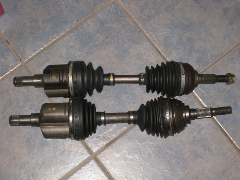

Rockauto / aftermarket can be unpredictable.
Here are two axles with supposedly the same part number:
Axle shaft diameters are different...
CV joints are different...
Only thing the same are the splines at each end.[This message has been edited by pmbrunelle (edited 04-20-2022).]
