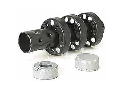

FYI: I have converted two Fieros to 3800SC engines, one in my sons 87GT and one in my 88GT, neither has a catalytic converter. Due to the smaller space on the 87GT, I installed the custom Spintek muffler with a 3 inch inlet and dual 2.5 inch outlets to the tail pipes. It has a deeper tone but was still a bit louder than I preferred but he lived with it for several years. Today, while fixing a slight weld crack on the inlet piping at the muffler, I did an experiment and installed a 3 disk collector insert into each outlet pipe from Jegs ( P/N 176-3D125R) made by Car Chemistry, Inc. . These are designed for street applications and/or race engines where there is a need to reduce noise. Each side was fitted easily into my dual exhaust piping after the muffler. For additional sound deadening, a person can also install stainless steel wool but I just went with the inlet disk block-off which comes with each collector insert. They also come with another disk insert which can also be installed on the collector outlet for the quietest results. I do not have a db meter but I believe I achieved about a 5 db drop in noise and my son likes it. I may install these also in my 88GT but it has the larger magnaflow V8 designed muffler and already has a quieter sound. The cost of each collector was $60.90 and I believe well worth the price.. just go to the Jegs website and check them out, they have smaller diameter collector inserts if your pipes are smaller. [This message has been edited by Curtisk1060 (edited 04-05-2022).]
APR 05, 08:53 PM
Is this what you installed? How do you prevent them from rattling?

Yes, that is exactly what I installed, it fit fairly snug into my 2.5 inch outlet pipes., First I lightly sanded the disks then also de-burred my exhaust pipes. I then welded the disk with the hole in it to the inlet side of the insert, and did not install the disc that had no hole in it on the outlet side of the insert, but according to the installation instructions, that would have made it as quiet as possible had I done that. They recommend tack welding the assembly in place or bolting them in place but mine just fit tight enough that I just slightly pounded them into my straight section of tail pipes before they turned 90 degrees to my outlet tips so they cannot go anywhere. I did not experience any rattle at all. The instructions provided were very easy to understand, hope that helps.. [This message has been edited by Curtisk1060 (edited 04-05-2022).]

Looks like you may be reducing the sound but by adding a severe restriction. The 3800 needs good exhaust flow or you can burn a piston or valve. ------------------ " THE BLACK PARALYZER" -87GT 3800SC Series III engine, custom ZZP /Frozen Boost Intercooler setup, 3.4" Pulley, Northstar TB, LS1 MAF, 3" Spintech/Hedman Exhaust, P-log Manifold, Autolite 104's, MSD wires, Custom CAI, 4T65eHD w. custom axles, Champion Radiator, S10 Brake Booster, HP Tuners VCM Suite. "THE COLUSSUS" 87GT - ALL OUT 3.4L Turbocharged engine, Garrett Hybrid Turbo, MSD ign., modified TH125H " ON THE LOOSE WITHOUT THE JUICE "
