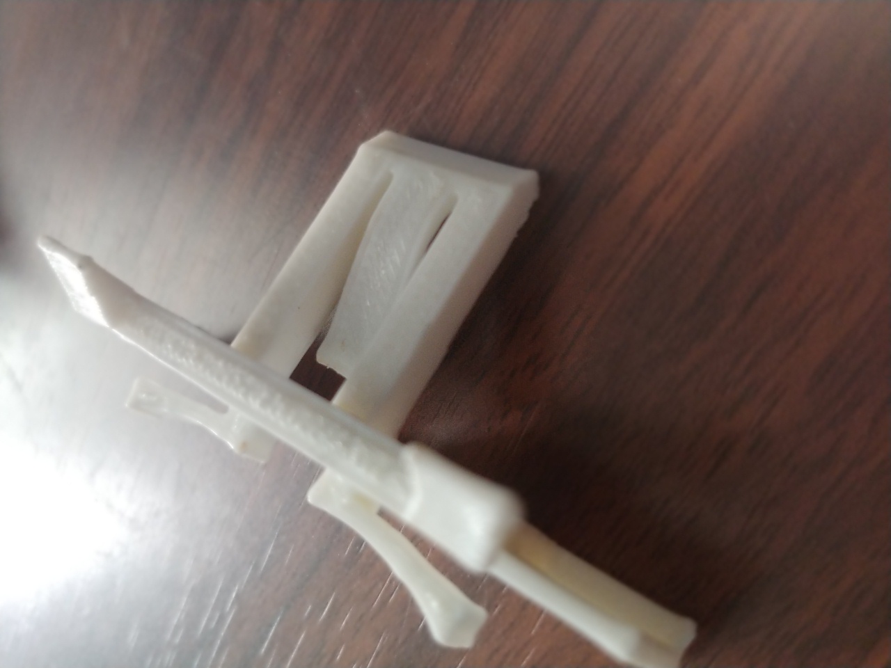

I made these a while ago but i figure i should put them on this forum as well
I drew up the two types of clips that hold the black stripe trim onto the door and fenders. I've uploaded it to thingiverse https://www.thingiverse.com/thing:4917631 they work pretty well, i've been using them on my fiero and theyve held in alright.
I hope this proves useful to someone. Might be cheaper and faster than getting them shipped from the fiero store if you already have a 3d printer.

Watch the plastic type...
While this part is not in Direct sunlight... Heat, Ozone and "water" will cause problems w/ some plastic types. "" means Polluted Water w/ road salt, oil, and worse crap.
OE ones die for same reasons and go brittle and snaps easy bumping the trim or try to remove trim after just 5-10 years.------------------ Dr. Ian Malcolm: Yeah, but your scientists were so preoccupied with whether or not they could, they didn't stop to think if they should. (Jurassic Park)
Just for the everyones information... if the part is going to be in sunlight, print with ASA. ASA has the same mechanical strength as ABS, but with better thermal and UV resistance. PLA should never be used for car parts IMO

ASA is a good choice. PETG is also a good choice. I've made many parts for my Fiero, including the reading light lens from clear PETG that amazed me how clear it was. Tricky to print clear but it does work better than not having the lens. FYI I used LEDs for the lamp because of significantly less heat than incandescent.
