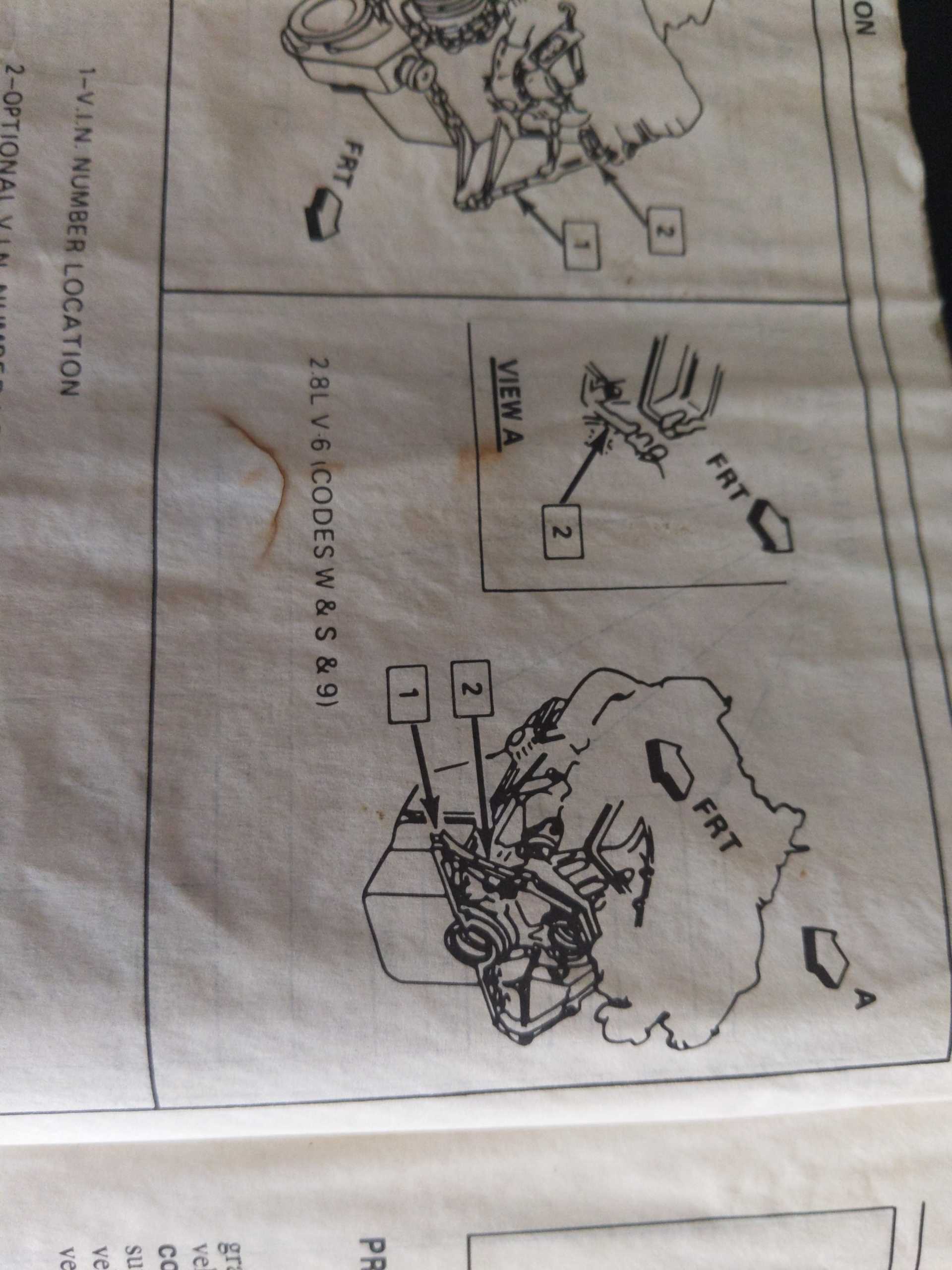

There may be a partial VIN on the engine in the area by the starter, on the mounting flange for the transmission.

FEB 14, 11:25 AM
This image is from the factory service manual

In addition to image, technically speaking it is located on the vertical flange where the engine attaches to the transmission, facing the front of the car.[This message has been edited by Skybax (edited 02-14-2022).]

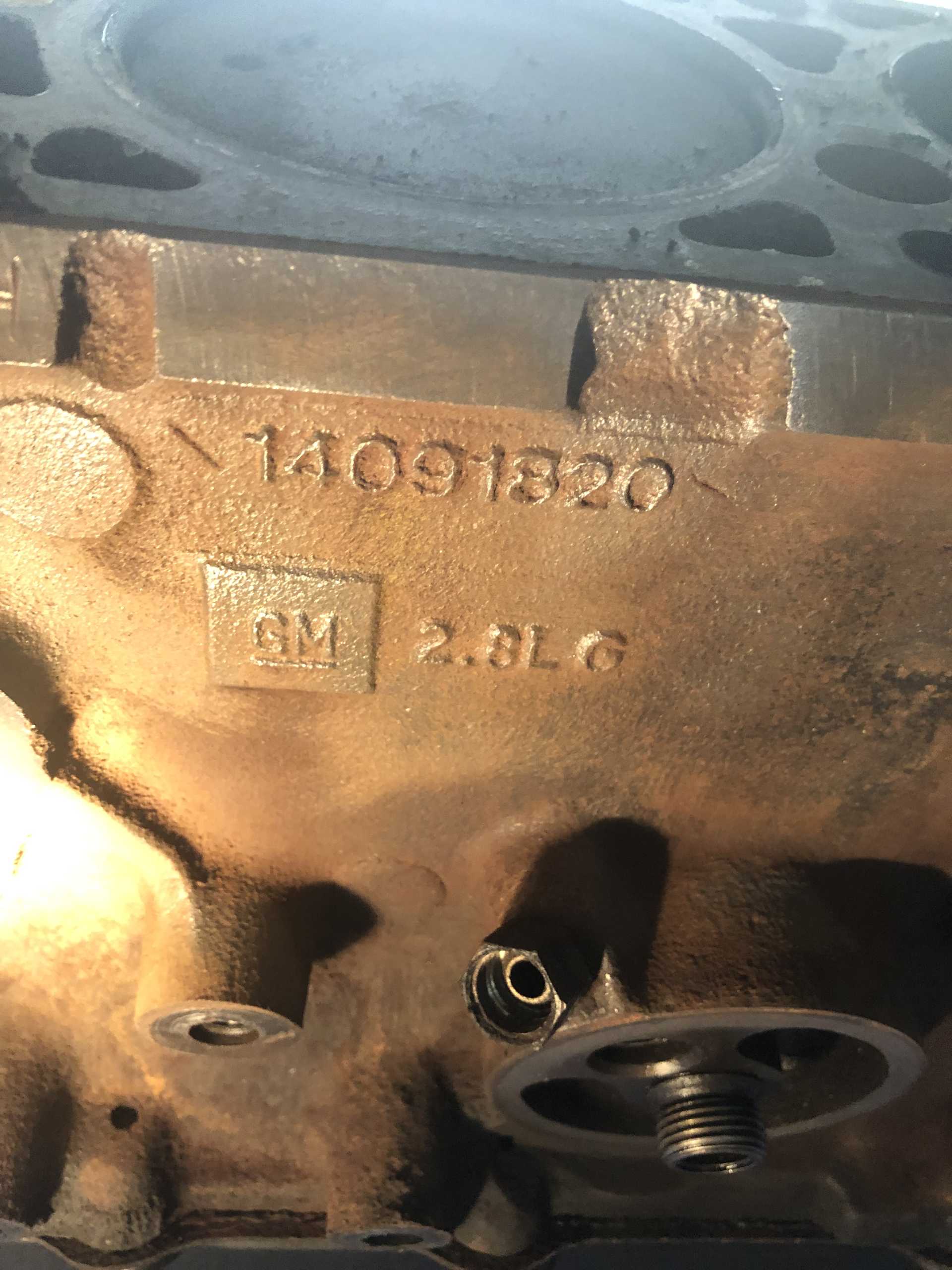

Here ya go ! Hop this helps..

Skybax
FEB 14, 08:45 PM
That's a photo of the casting number, showing what years/makes/models that block was intended for, and showing its a GM 2.8 engine, that might be all that's needed...
Casting # 14091820 was for: Make: GM - PONTIAC Year: 1985 - 1987 Liters: 2.8L Cubic Inch: 173 VIN Code: 9 Engine Type: V6-OHV, CHEV, MID-ENG
I think LeoLeChat needs the VIN stamping off the engine, when the engine was installed on the assembly line, to show it matches dashboard VIN. (but I could be wrong) It's located on the vertical flange where the engine attaches to the transmission, facing the front of the car. (see olejoedad photo)[This message has been edited by Skybax (edited 02-14-2022).]
