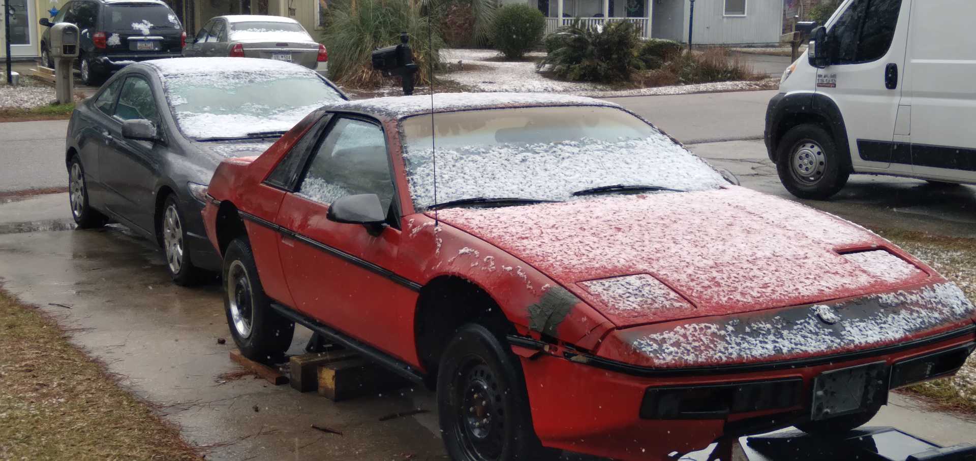

So my 17 year old son brought home a " real gem"...... I'm new here so if I post in the wrong place I'll repost ,just let me know.. iron Duke runs good. I'm almost positive it's the Isuzu trans.. can't shift into any gears. 5spd.. almost like the clutch isn't engaging. I replaces the pedal with no luck. Any way to check ? Where should I go from here? I've got a manual, but not able to troubleshoot it from here. Any tips or insight would be greatly appreciated. Thank you!!! P. s. Single father here not really interested in a LS4 swap or anything crazy! I'm on a budget ... thank you for your help------------------ daniel lunn
