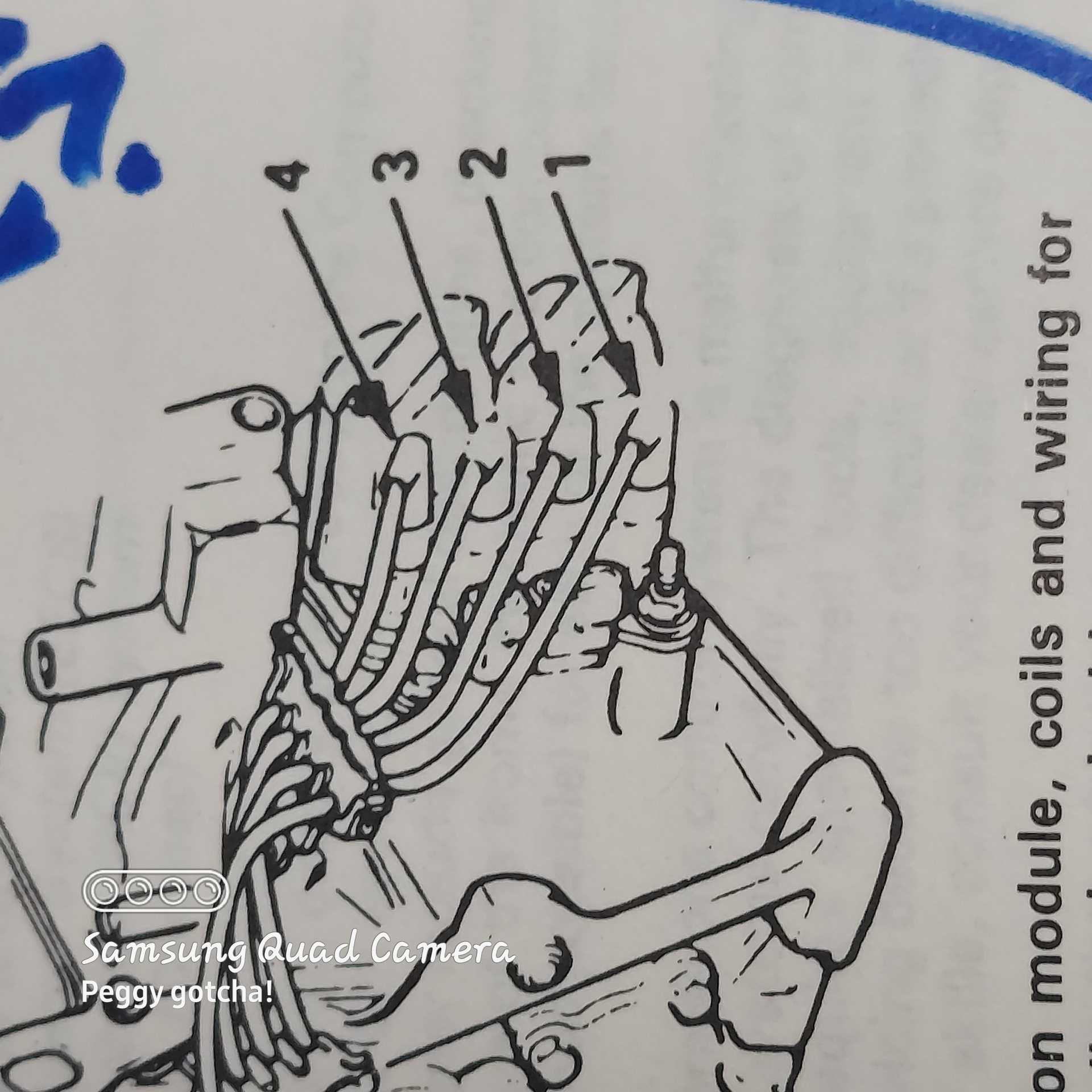

Isn't the order 2341? From top to bottom. 2nd Gross mistake if true. This page is from a Haynes repair manual the version that has has revisions for later models.This is unacceptable for a highly read repair manual. Luckily I need at least 2 concrete answers that result in same answers to any of my problems. I have 3 repair manuals. I hate doubting myself but for peace of mind it's totally worth it.

The Chilton's Manual shows 2, 3, 4, 1 from top to bottom as mounted to the engine. Look on the coils or on the sides to see if they are marked.

Do you have a factory service manual? If not, there are links available for download.

Yes I do just wanted others to know about this. I recommend the service manual and to always verify the what Haynes manuals say. Haynes has many mistakes that could really damage things.
