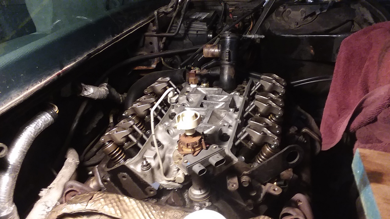

Getting closer to firing the old girl up again
eti engineer
OCT 24, 10:03 AM
| quote | Originally posted by Notorio:
Looks like a nice rebuild!!
