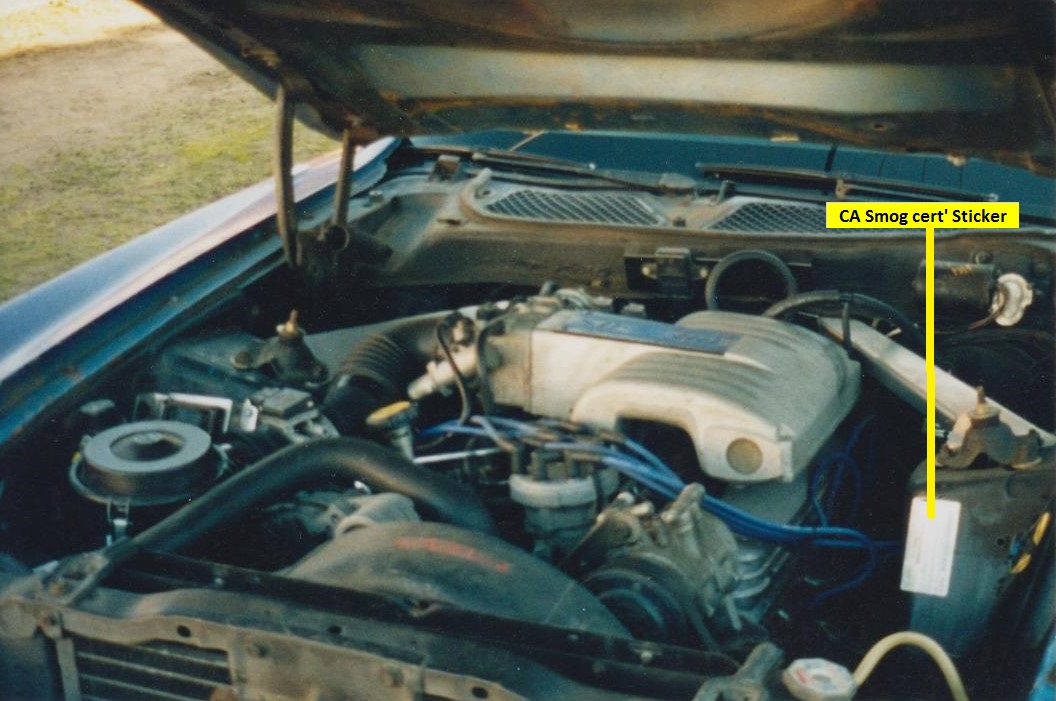

I swapped a 5.0 FI engine into a 1973 mach 1.......In California; And then I died!
Actually, the rules are; Must be same year or later, must have ALL smog equipment connected and functional, must have no codes, and then you take it to a referee station and get certified (The car, not the owner)
Interestingly (And amazingly) CA did NOT require a CAT on my Mustang because the car was not designed for one and may cause fire.......
Also, I can vouch for the 2.8 to 3.4 long block conversion- only 20 hp more but at lower RPM so it's like having a better gear ratio; My Fiero now gets to 60 in 6.5 seconds and does the quarter in 14.8.....And it has passed smog for the last 7 times (Engine swapped in 1999) (Fails were an old CAT and then a bad ICM)
The 3.4 is actually a LEGAL swap in CA- GM only made the 60* V6 replacement blocks in the 3.4 size and was able to get it certified in CA.[This message has been edited by cvxjet (edited 10-12-2021).]
