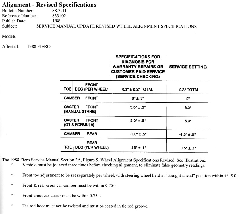

A) Here is the alignment specs out of the manual.....
B) Lowering the car an inch will not make any big difference as far as alignment is concerned.....The stock specs are generally good to go.
C) If you want to improve handling a bit, go with more negative camber up front (If possible- 84-87 you would have to use an aftermarket BJ which is designed to allow Neg' Camber) and especially more POSITIVE caster.....this will make the front tires stick a bit better and aid turn-in...also better return in the steering.[This message has been edited by cvxjet (edited 10-02-2021).]
