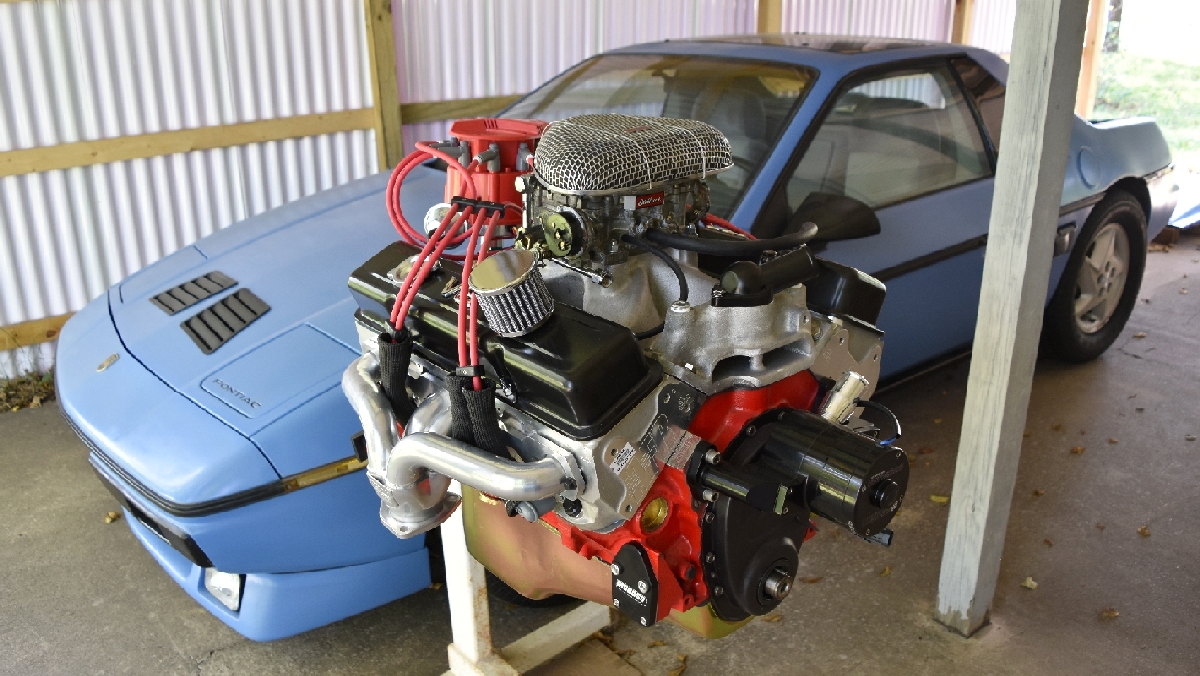

My V8 Fiero with a worn out engine has sat untouched and neglected for 11 years. As a combination retirement and pandemic project, I have restarted my SBC Fiero swap. I have forgotten half of what I once knew. So, I will have questions for those that have done this swap before.
Teaser photo taken yesterday (see image). Just another old school 400 HP SBC 355. I can provide specs if anyone is interested.
First question is about water pumps, I bought a Meziere electric pump because I have one in my 2004 GTO that has held up well. Now that it's trial mounted on the engine (upsidedown), it looks big. Will this pump work? Has anyone else used one before?

The old school SBC approach looks nice but is seldom used anymore for three reasons. 1. The tight fit in the engine compartment due to overall length. Using that water pump will necessitate cutting away a portion of the wheelhouse. To avoid this you can use a remote electrically operated water pump. 2 You cannot use a later day (stronger) GM automatic transmission. You can use the TH125 but it must be custom built to take the power and it limits you to three speeds. 3. If you go manual the Getrag is a poor choice as it will only survive long term with 200 ft lbs of torque. If you use an engine with twice the power you will need to change to the stronger F23 or F40. Not trying to discourage you, just advise what needs to be done for a reliable swap.------------------ " THE BLACK PARALYZER" -87GT 3800SC Series III engine, custom ZZP /Frozen Boost Intercooler setup, 3.4" Pulley, Northstar TB, LS1 MAF, 3" Spintech/Hedman Exhaust, P-log Manifold, Autolite 104's, MSD wires, Custom CAI, 4T65eHD w. custom axles, Champion Radiator, S10 Brake Booster, HP Tuners VCM Suite. "THE COLUSSUS" 87GT - ALL OUT 3.4L Turbocharged engine, Garrett Hybrid Turbo, MSD ign., modified TH125H " ON THE LOOSE WITHOUT THE JUICE "

I have a CSR brand pump on mine, it looks almost the same, its a tight fit vertically, depending on how low your engine is set into the vehicle. Length wise yo need to have a hole on the inner wheelhouse, maybe you can beat it down with a BFG for clearance? or mount remotely as previously stated. ------------------ 84SE, aero body, 4 speed and an injected 355 V8

Dennis, you provided valid points and excellent advice. However, my Fiero already had a SBC swapped in 22 years ago when I bought it. Then, in 2010, I started building this engine (photo in post 1). The short block is done and I had already gathered most of the parts (about $4k spent on the engine). Long story short, I'm stubborn and committed to staying old school.
Previously, I had a belt driven water pump with the cogged pulley in the wheel well, but this time I wanted to go electric. So, there has been some cutting and trimming done. You mentioned remote locating an electric pump. I had not seriously considered that option yet. But, I think it might be a worthy "Plan B" if the Meziere doesn't fit while mounted on the engine.

MafV8, thanks for the info. So, my electric water pump perhaps maybe might fit with enough tweaking.
Here's what it looks like now. So previously, some trimming (hacking) was already done.

Back to the water pump, after some measuring and eyeballing, I think the Meziere unit I have will fit, if I do a little more wheel well trimming. If not, I'll mount it remotely and get a pair of block adapters.
