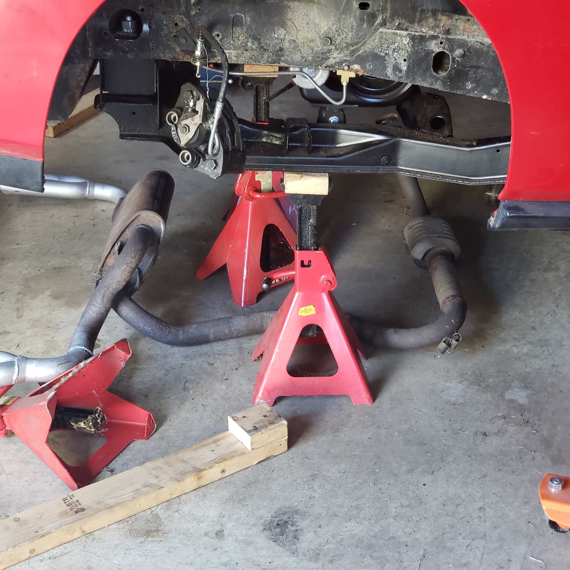

'88 V6 exhaust questions.... Remove and (especially) reinstall/replace the system. I pulled my engine. The exhaust system was the LAST thing I removed from the cradle. It came off in one piece. I have since reinstalled the engine, but I did so without reinstalling the exhaust. I was thinking it would slide into place no problem. This doesn't seem to be the case. Has anyone reinstalled their exhaust - all in one piece with the engine in the car? I suspect this can not be done. So......

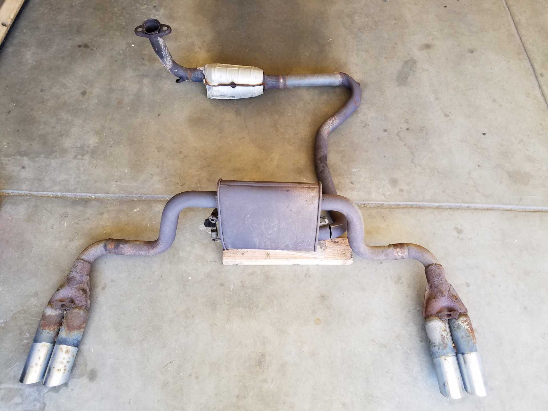

I installed the Fiero Store Ocelot aluminized exhaust in my '88 GT in 2016 or '17. I like it and it's still looking about as new as it could be, given 5 years and about 22k miles. Not showing any rust, but I am in Colorado and don't drive it in snow (or heavy rain, unless caught in it). I like it, At the time, I replaced everything from the Y-pipe back.
What I took out:
Notice the cut just before the muffler (and the seriously wrecked cat). I tried to take the entire exhaust out in one piece, and only failed because I had the rear on jack stands and did not have enough clearance at the headpipe (top hit the floor). Since I knew I wasn't re-using any of it, I used a sable saw to cut it in the most convenient place (exhaust was on the ground under the car) so I could tip the front half and drag it out. If I had the front and rear of the car off the ground, it would easily have come out in one piece.
Regarding the Ocelot system, it al went in pretty easily. I used a Walker 15026 cat (currently $119.71 on Amazon, was much cheaper a few years ago). I had to add a pipe to make up for the length of this small cat relative to the larger stock one I think the Ocelot was designed for (but not what was in the car when I bought it), and (iirc) I had to trim an inch or so off the pipe that runs along the passenger side, but then it all fit. I have hangers that I built from the OE brackets and universal hangers in the back, and about half of the OE springs installed (couldn't make the others fit). But it's solidly mounted and no bad resonances in the cabin.

The exhaust was last out, but not first in. I'm trying to put it in last. It was easy to remove it from an empty cradle. With the engine in the cradle it's a no go. Look at the picture above. Top of the muffler and the head pipe lean in towards one another. The space between these two points is more narrow than the cradle and engine. I've decided to cut the exhaust and clamp it back together. One cut is all that's needed. Not an ideal solution, but it'll work for the short term. ------------------ Stanton '88 Formula, red on gray

I've always removed the exhaust as one piece from the crossover connection downpipe back with the cradle and engine still in the car. I can see your cat has been replaced and welded in and to me it looks like the downpipe connectionis angled rearward more than mine were. How does that fit to the downpipe? It is at an angle at the donut gasket when it was mounted? But a factory exhaust even with aftermarket cat should come off and back on the car mounted cradle, no problem. I've had two complete exhausts with the massive factory cat still attached and had no problems even with that. With an aftermarket cat it's even easier because those are typically clamped on and one clamp can be removed to leave the downpipe attached. All but one of mine were 88s as well. I'm glad you've got things figured out though. [This message has been edited by reinhart (edited 09-10-2021).]
