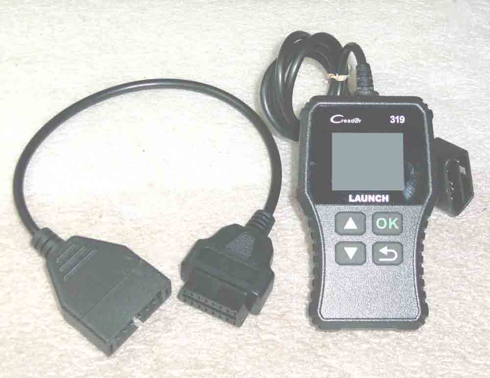

Has anyone ever tried using this type of adapter to connect to your OBD2 scan tool? I purchased this one on ebay for around $8 and tried it out but didn't seem to work after plugging it in at the ALDL port (it flashed on for a hot second then no screen at all)...

I don't know if the ALDL connector can provide power out to that device.
AUG 22, 07:22 PM
98+% OBD2 scanners will Not work on OBD1 systems even if you find "Adapters." Worse can wreck the scanner and/or ECM trying that. Very few if any "Pro Grade" OBD2 scanners might read OBD1 data.
Very few OBD1 scanners are "Universal" and read some to many car makers because ALDL plugs and more aren't standard across brands. Old Snap-on and other High $ OBD1 scanners does this often w/ High $ "modules" to program them. Worse often need several "modules" to work w/ 1 brand of vehicles.
Is why many OBD1 scanners only fit one brand of vehicle. So GM scanner won't work for Ford and others.------------------ Dr. Ian Malcolm: Yeah, but your scientists were so preoccupied with whether or not they could, they didn't stop to think if they should. (Jurassic Park)

It looks like you tried to use an OBD2 scan tool on the ECM w C3 interface or in a stretch called OBD1. They have two entirely different data streams. I don't even know why they made those OBD1 to OBD2 adapters. They will not work. ------------------ " THE BLACK PARALYZER" -87GT 3800SC Series III engine, custom ZZP /Frozen Boost Intercooler setup, 3.4" Pulley, Northstar TB, LS1 MAF, 3" Spintech/Hedman Exhaust, P-log Manifold, Autolite 104's, MSD wires, Custom CAI, 4T65eHD w. custom axles, Champion Radiator, S10 Brake Booster, HP Tuners VCM Suite. "THE COLUSSUS" 87GT - ALL OUT 3.4L Turbocharged engine, Garrett Hybrid Turbo, MSD ign., modified TH125H " ON THE LOOSE WITHOUT THE JUICE "

Thank you for the replies everyone.. and thanks for the link Lambo - I may give that one a try. For now I'm gonna just try reading the flashes using the jumper procedure and see what codes it throws.
