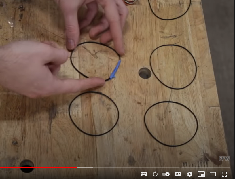

Edit to add......I just found Ronald Finger's video on Youtube where he repairs his factory cassette deck and actually says he bought a bulk pack from Amazon and he found a few that worked. They give multiple thickness belts so he just needed to use the proper thickness. Here's a pic from the video where he taped his together with blue tape to find the right size.

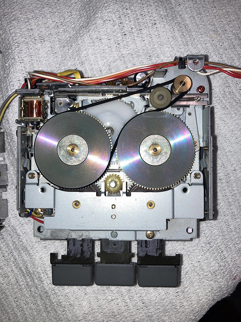

Alright, I took mine apart and my belt was barely holding on. It was perfectly form-fitted to the pulleys but I was able to take it off with almost no effort. I cut it and it measures 8.5 inches so I'm guessing an 8" belt would work. I just ordered an 8" and an 8.4" belt. We'll see what happens when I receive them.
FYI https://www.turntableneedle...ber_Drive_Belt_Small
This is what mine looked like:
 [This message has been edited by IMSA GT (edited 09-05-2021).]
