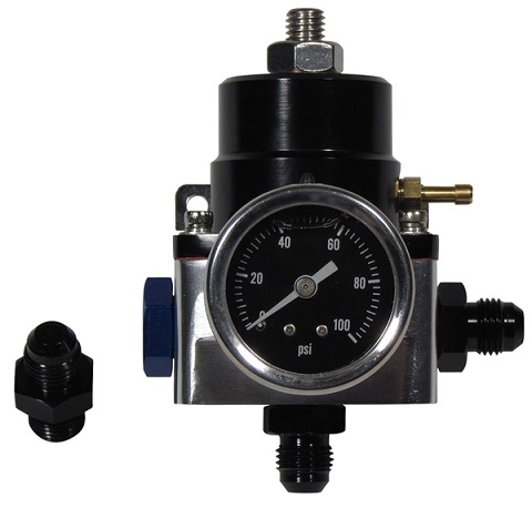

I`m running a series 3 fuel rail on a 3800 swap in my 88. I`m using a FPR with an inlet / outlet and return. My car doesn`t have the expansion tank and the lines are all messed up anyway so I just leave the cap loose. With my swap I just want to put an aftermarket charcoal canister connected to the vent tube of the pick-up assembly. My question is, will the vacuum port on the LIM be enough for the MAP, the FPR and the charcoal canister? Thanks

The FPR and the MAP need to see actual LIM pressure. Neither of these flow air. They are sensors. Putting one of these on a vacuum line with something that flows vacuum (the charcoal canister) means the sensors will no longer be seeing accurate vacuum/pressure. So to conclude this the FPR and the MAP need to be on a nipple that is directly in the LIM and nothing else is connected to them.
