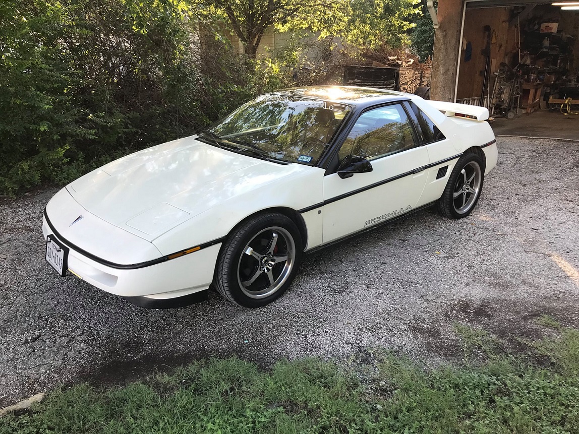

I just cut about 1/8" deep at a time, then held a wet rag around the coil. It kept it cool. I know that cutting springs changes the compression rate but I didn`t really notice it after cuttting mine. Here is mine with 1" lowering ball joints and 1/2 a coil cut from the spring.
