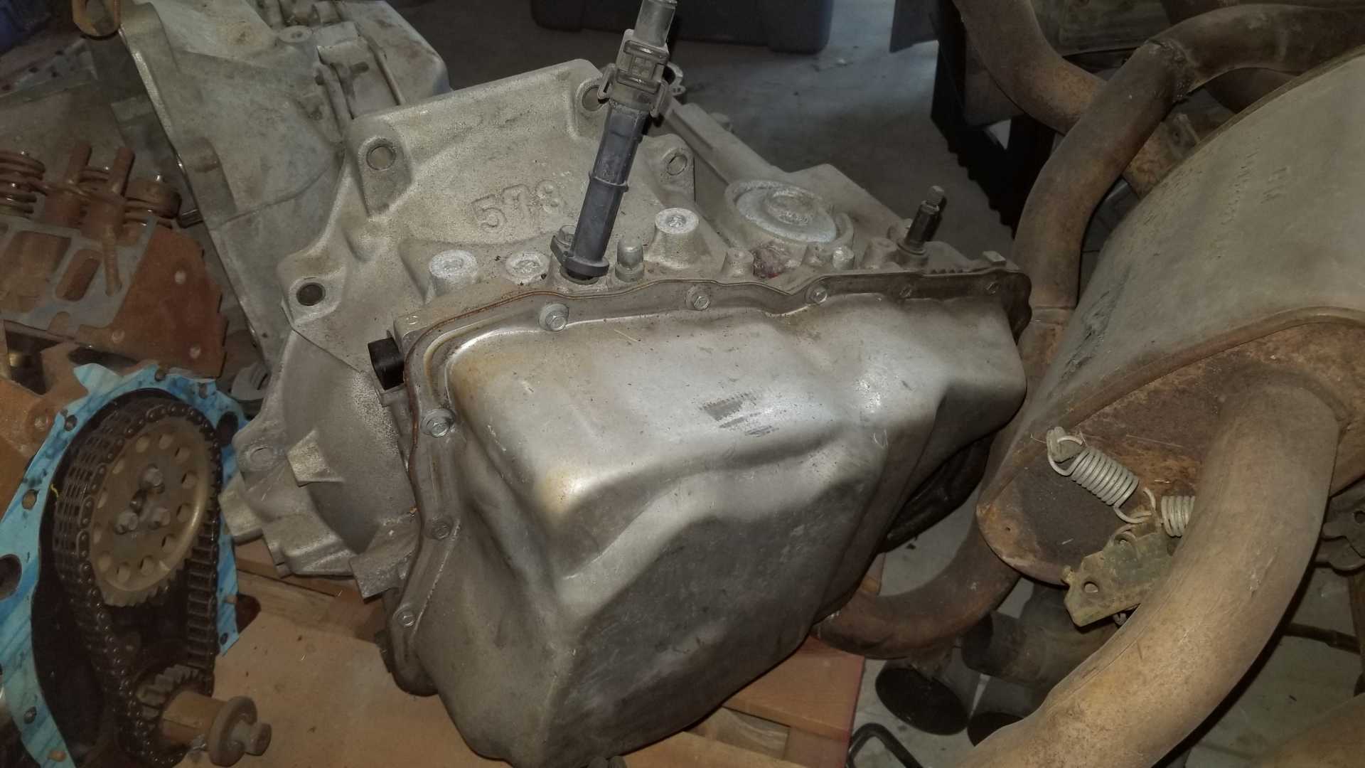

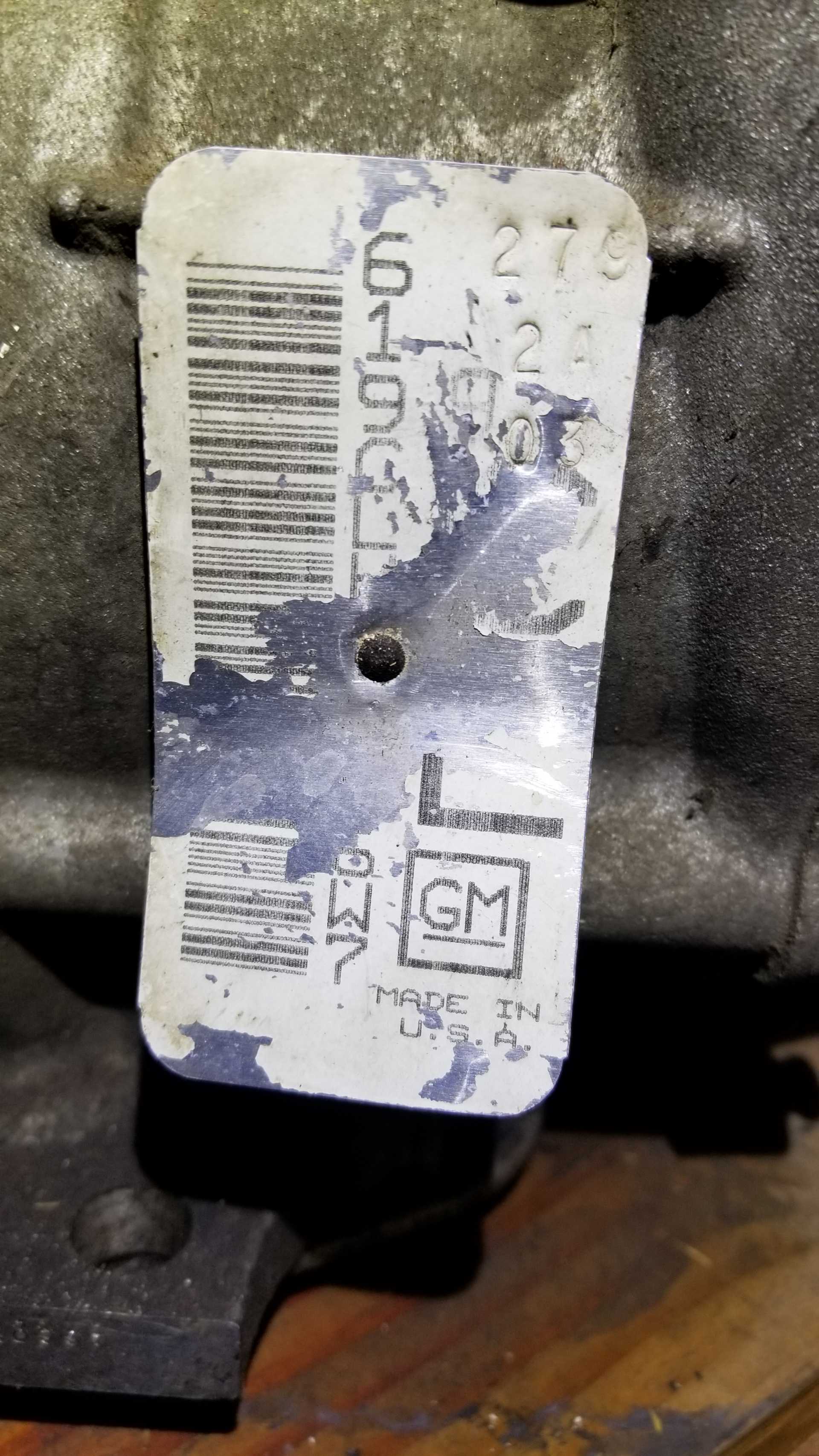

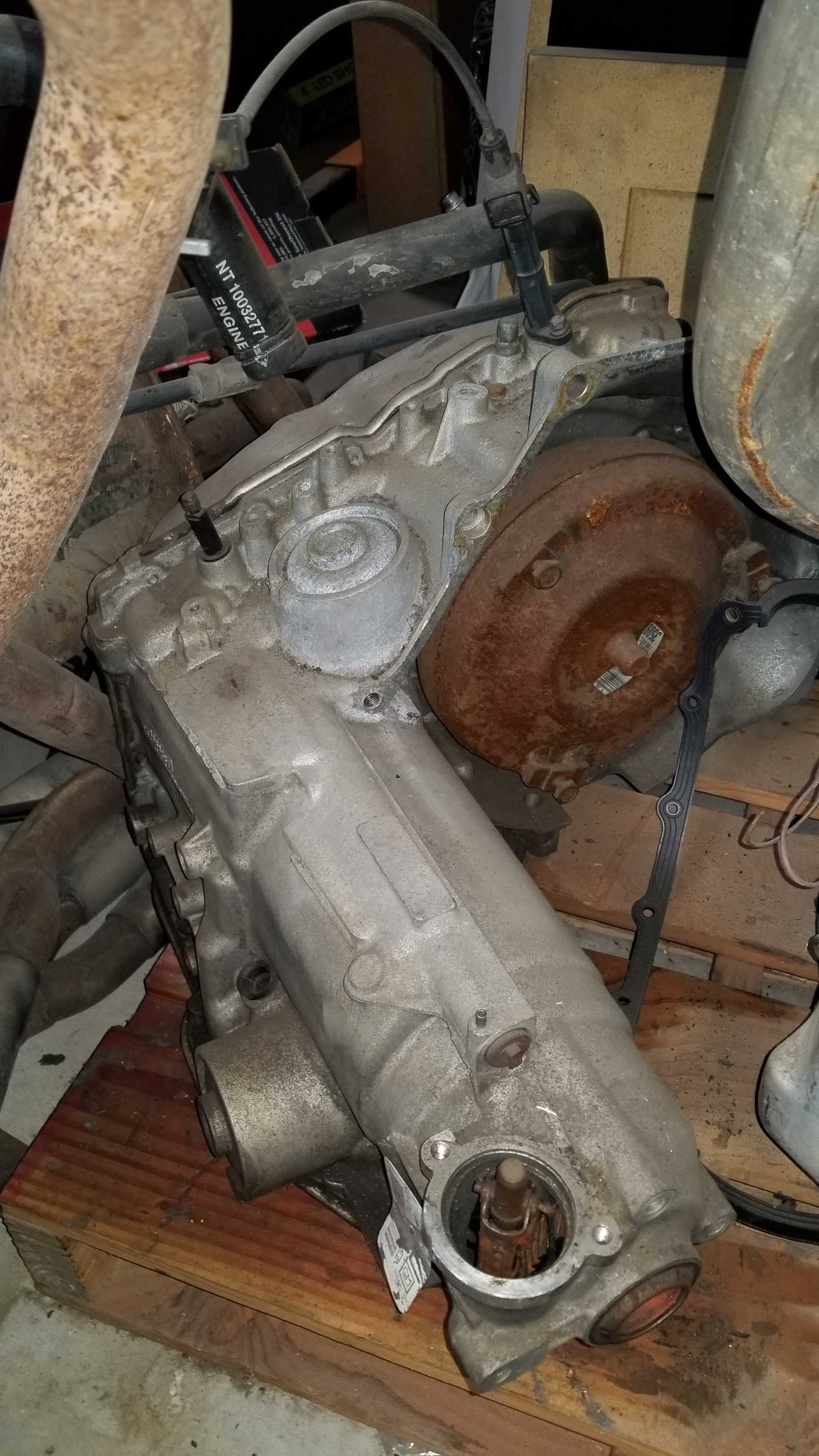

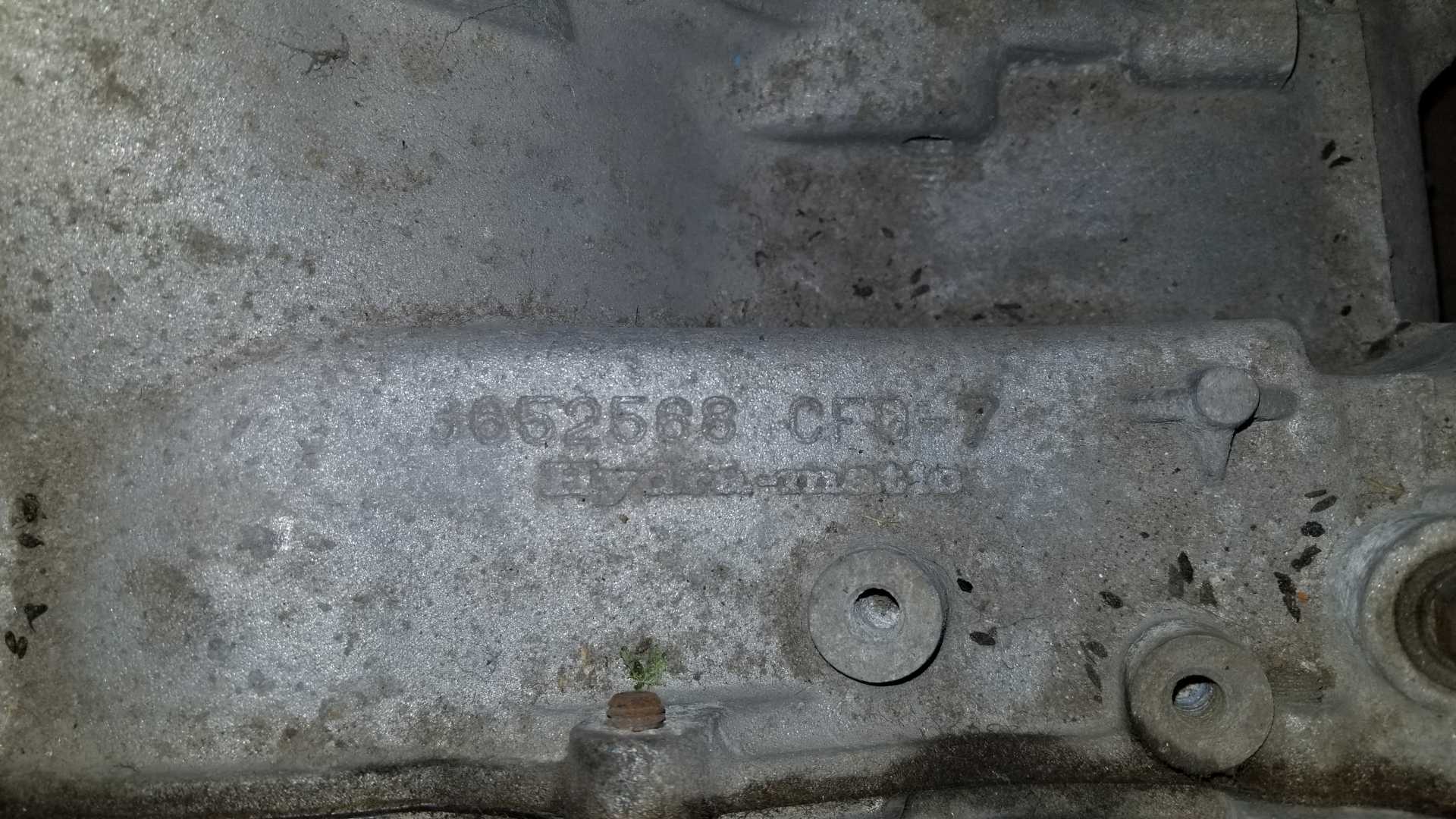

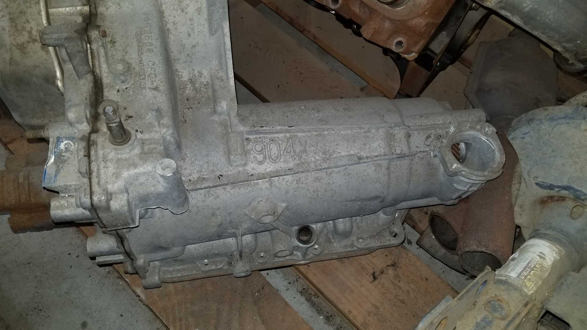

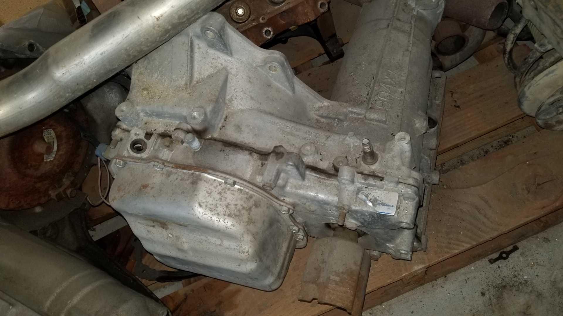

I have a couple of Automatic transmissions in my shop that I can't identify
Transmission #1
Transmission #2
cmechmann
JUN 21, 08:03 PM
The 1st one looks like a 440t4 or very early 4T60 not 4t60e. Being that it has integral passenger tail stock, I would say 440t4. Later 4t60 and 4T60e had removable tail stock. like the 4T65. The 2nd looks like a TH125

OldsFiero
JUN 22, 07:47 AM
#1 is440T4 (4T60). #2 is 125C (3T40).

Is there any way to tell which type of 4T60 (what the gear ratio is) by the stamped numbers?
