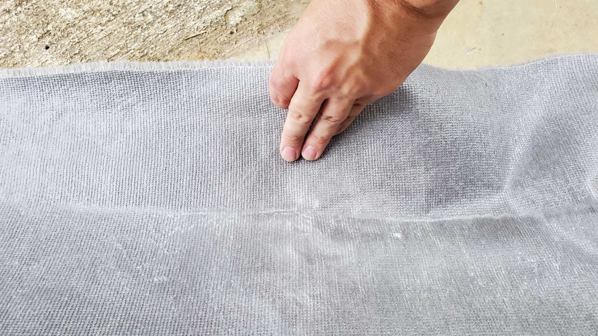

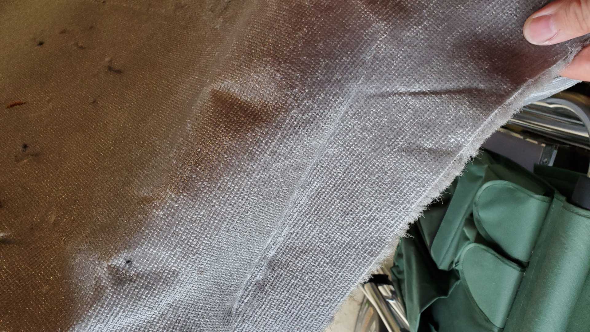

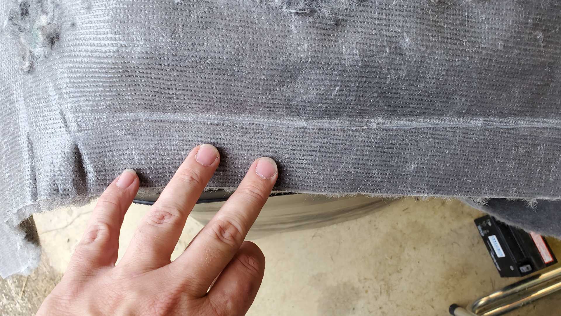

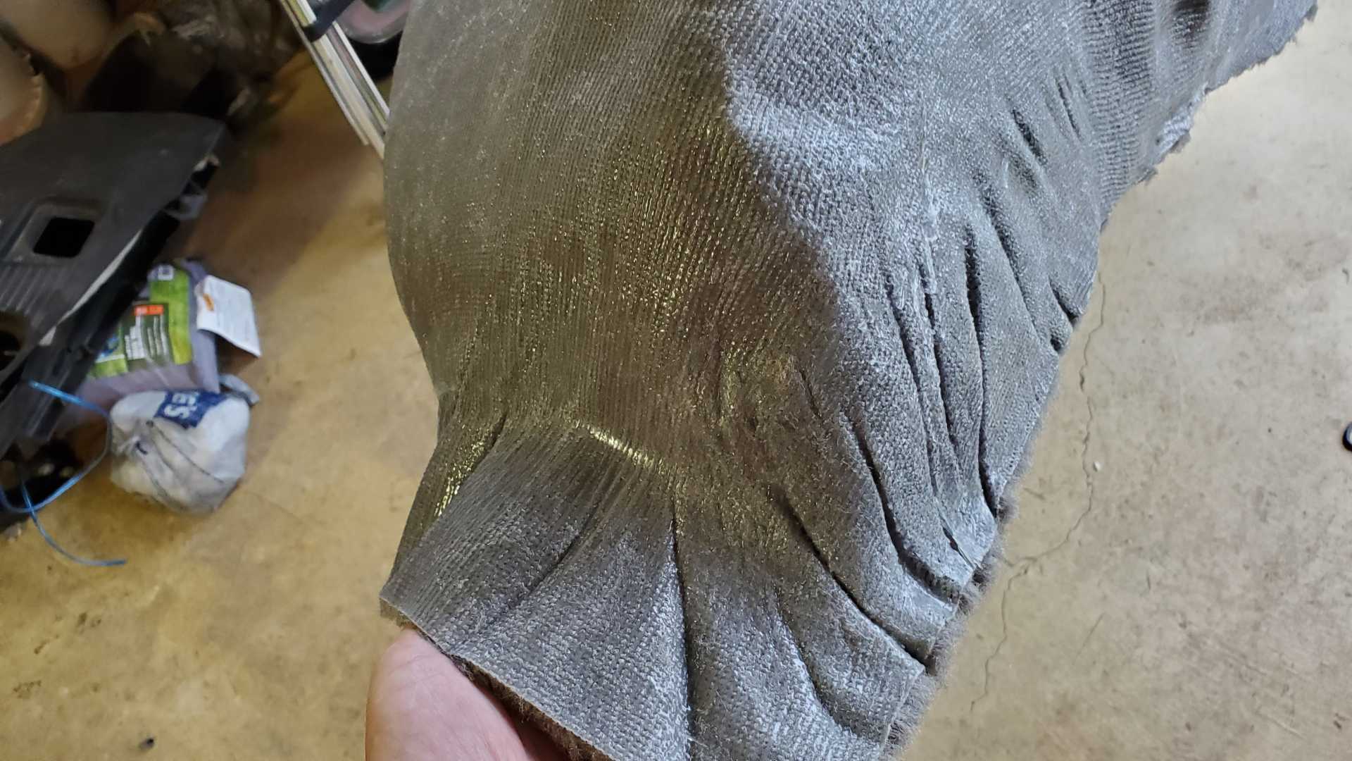

Hey all. I'm in the process of replacing (actually installing over...) my old carpet with a new ACC kit. I'm sure some of you have done it, so any advice/help is greatly appreciated.
I'm having some trouble with the fit...The "molding" seems less like definite areas, and more like recommendations of where it's supposed to be. It's also grossly oversized-I can't even get it in the car into a position to see where I need to cut or make holes. I know they purposefully make it larger, but it seems a bit excessive to me.
There are what appear to be mold lines, but I'm not sure if I should just go ahead and cut them out or not. I've attached pictures showing the lines.

Some of the lines in their carpet is because they take it out of the mold and fold it up to store it before it fully cools. Someone once told me a customer could contact them and ask them to leave one to get 'cold in the mold', but I didn't have any luck when trying to do that. So I just got it through RockAuto.
