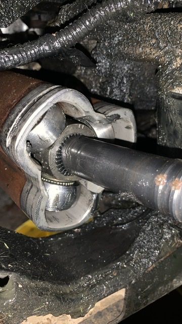

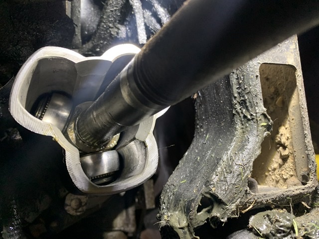

87 and a 4t65e-hd with Roger’s mounts The 3800 axle is way too long and I put together last night a manual driver’s axle and it’s questionable on the depth of the tripod
Is there any axle that’s a medium between these two??

That’s the axle that was used and it had the tripod buried against the bottom of the 3800 cup rubbing the balls against it ☹️

I`m having a problem on the passenger side. I got axles with a set-up 3800 already on the cradle. The trans, I believe from what I have read is a non-hd as it has no roller bearings in the diff end. I believe the mounts used maybe from WCF but I`m not sure where the axles came from. The one on the drivers side looks like it will work ok but the one on the passenger side it fits into the diff and it fits into the Fiero hub. The problem seems to be it`s just a bit too long. Basically, if I compressed it all of the way it may fit between the diff and the back face of the knuckle but I don`t think there would be any play. When you level suspension (88) with the axle in line with the diff (being in it`s most compressed state, how much play should it have? In other words if I pull the knuckle out, install the axle and slide the hub over the splined part of the axle but not install the nut how much play should the axle have when pushed toward the diff. I would think at least maybe 1/2"
