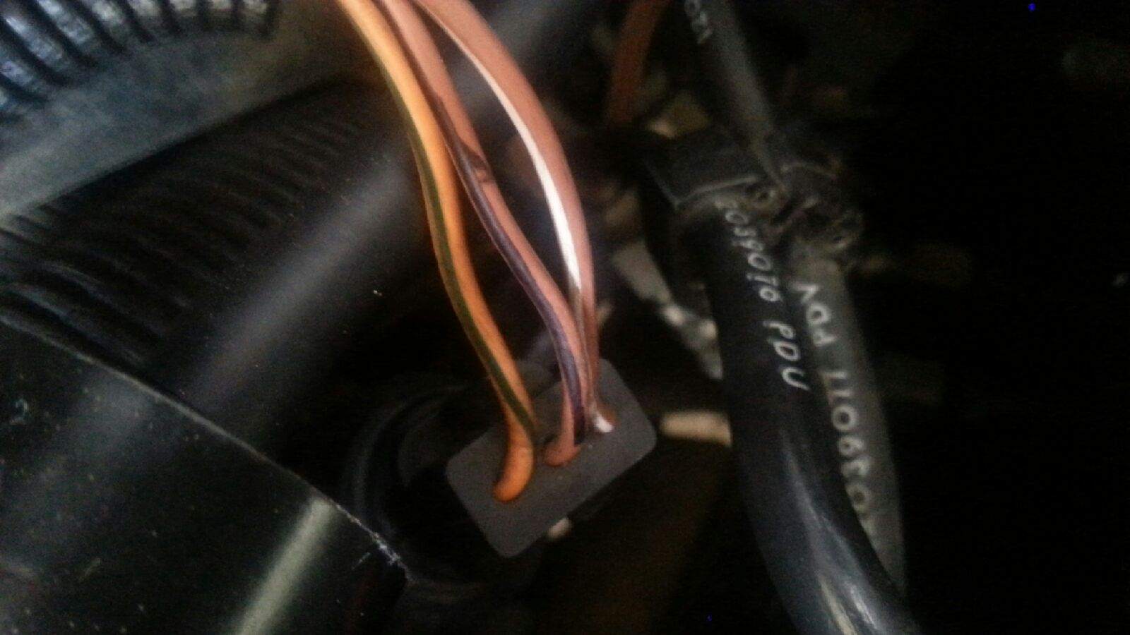

I'm converting my 1986 oil pressure sender to the later 1988 style, and I'm reading conflicting info when it comes to wiring up the new style connector...
They are both 3 wire, and some posts in the archives say the middle wire is the ground, while the other two are interchangeable.
So I'm looking for clarity on this...

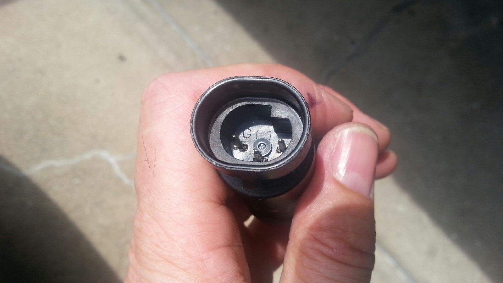

1. When they say the center wire is ground, I assume they are talking about the 1986 connector with tan wire? 2. When I look at the NEW 1988 sender socket pins, the pin on the LEFT is marked "G", doesn't that indicate ground?

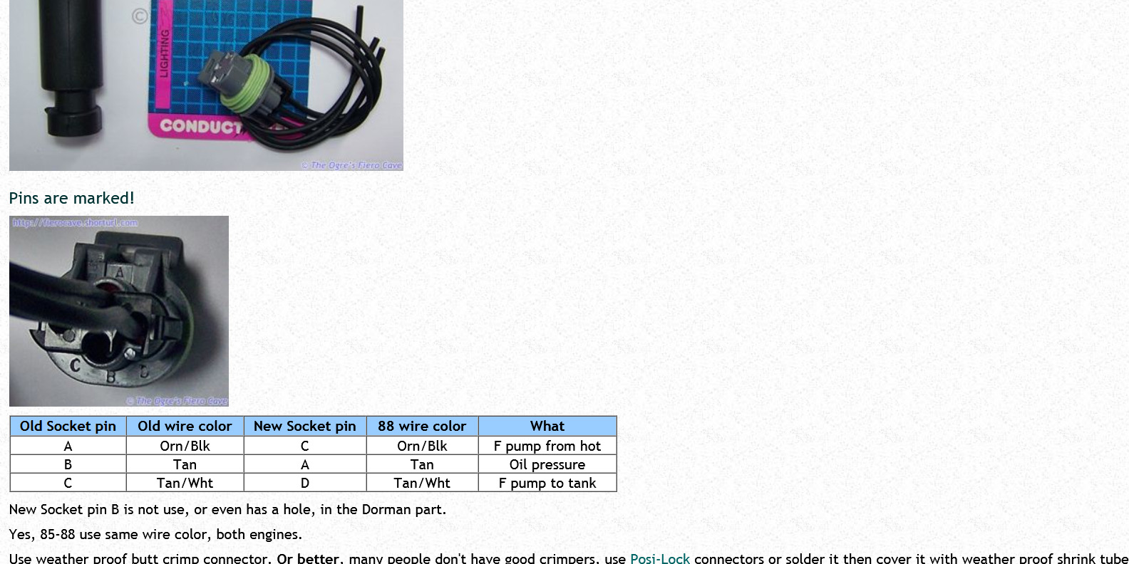

Got the wire info from Orge's site...
...just curious what the "G" means on the inside on the new socket.[This message has been edited by Skybax (edited 06-07-2021).]

I switched to the '88 style oil pressure sender, because the early type would only last 6-12 months before they started leaking oil. That got pretty annoying. I was able to get the pigtail from an '88 Fiero wiring harness. The wire colors were the same. So I just connected the same color wires together.
