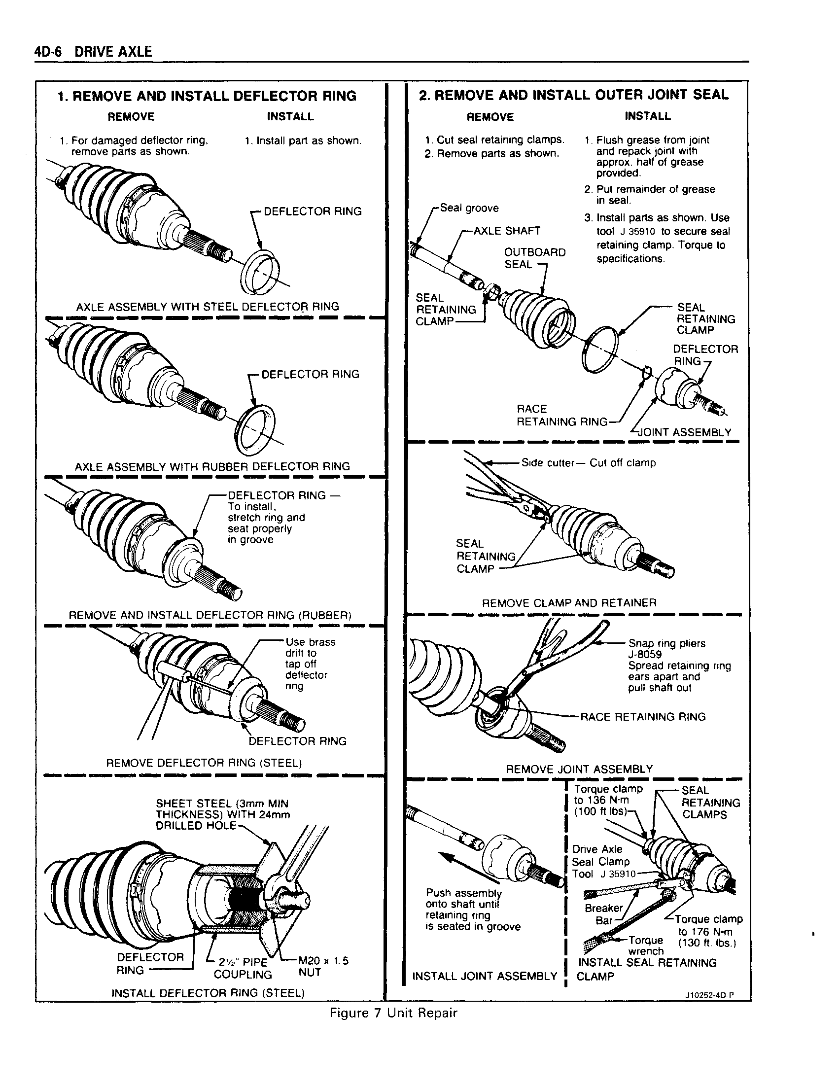

Mark_j
MAY 23, 09:11 PM
Hope this helps:

Markeeise
MAY 23, 10:28 PM
| quote | Originally posted by Mark_j:
Hope this helps:
It helps a bit, but I cannot find the race retaining clip, is a 88 axle different ?

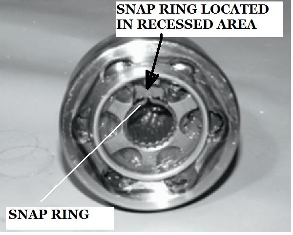

Mark_j
MAY 23, 11:43 PM
| quote | Originally posted by Markeeise:
The picture came from the '88 Service Manual. The snap ring is in there very close to the inner race. As the picture below shows, the snap ring may be recessed. With all the grease in there it may be very hard to see, but it's in there.
Markeeise
MAY 24, 09:57 AM
Thanks, I took a really close look through all the grease this morning and I believe I found it. When I get home later I will try and remove it.
