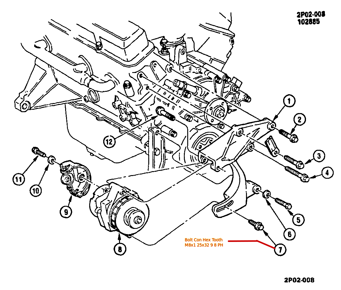

Can anyone post a pic of the V6 alternator adjustment bolt with the tooth washer off the bracket please?

Picture of the entire alternator mounting assy:
It doesn't use a toothed washer the bolt flange is toothed.[This message has been edited by Mark_j (edited 05-14-2021).]

| quote | Originally posted by Mark_j: It doesn't use a toothed washer the bolt flange is toothed. |
Yup, worse that bolt is rarely used anywhere else. Large alt pivot bolt is found nowhere else.
I have (had?) a spare but can't find it now.
might use a bolt w/ large captive tooth washer but also hard to find spares of these for bigger sizes.

| quote | Originally posted by theogre:Yup, worse that bolt is rarely used anywhere else. Large alt pivot bolt is found nowhere else.
might use a bolt w/ large captive tooth washer but also hard to find spares of these for bigger sizes. |
Yeah. The cross reference doesn't show much either. Items like this are better found on yard cars. Best bet would be anything up to about the mid 90's using a similar alternator. I have found bolts that are close (flanged) at Ace Hardware in the nuthouse or at Champion Bolt.[This message has been edited by Mark_j (edited 05-15-2021).]
