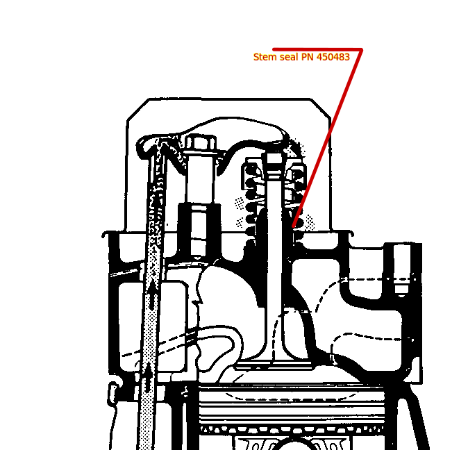

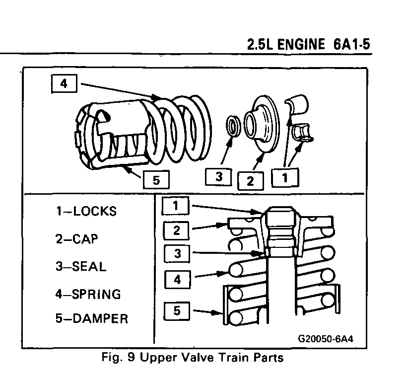

From GM P manual:
Engine type P LR8/2.5
Valve stem seals - 8
Stem P/N 450483 (goes on the valve guide) O-Ring P/N 3835333 (goes on the stem under the spring cap)
See figures 1 and 2
Figure 1.
Figure 2.
1986 GM service manual says to replace both seals so you should order both the stem seal and the o-ring. To break this down properly, you would need to order a set of 8 stem seals and a set of 8 o-rings. I don't know what the shipping rates are for your location but ordering both the part(s) sets is good insurance since the part cost is fairly minimal.
