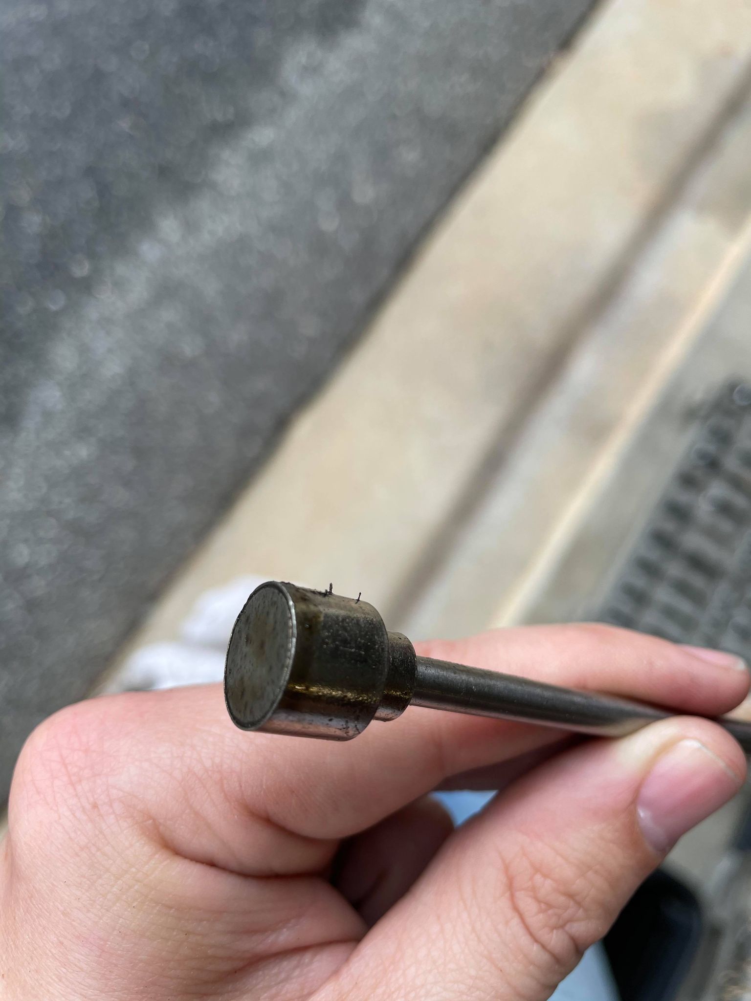

You should have a lot of metal in the oil pan and cam valley. Can drain the pan and simple look at oil or send to lab to test the oil.
Hmm...drained the oil, which had about 1,000 miles on it and a lot of idle time while troubleshooting.
Just had these two shards after moving the magnet throughout the oil twice (2nd time no metal).
