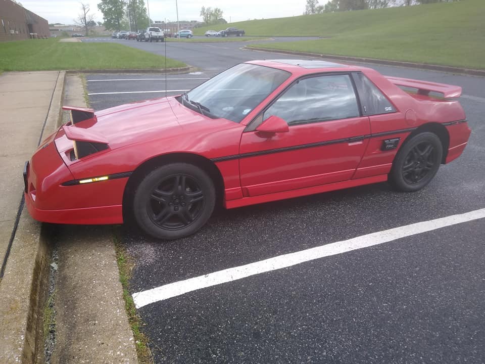

From a 2003 WRX. Good deal too $150 for all 4 with new tires on them....guy is more bing and just needs them gone. I know the center bore needs to be enlarged 1 mm to 57.1. Anything else I should know or do? Never put one brand on another before.

Fly cutter on a Bridgeport. Easy peasy. I need to 3D print some center caps now. The hubs stuck out 1/4 inch. Rides great. I could have taken a little more out. They are tight but go on. Clearance Clarence.[This message has been edited by Curlrup (edited 04-29-2021).]

These were silver. Previous owner plasti dipped them. I'm going to peel it and paint it...correctly. The dip is on for now, it works but if you get close it looks sloppy. No sir I don't like it.
