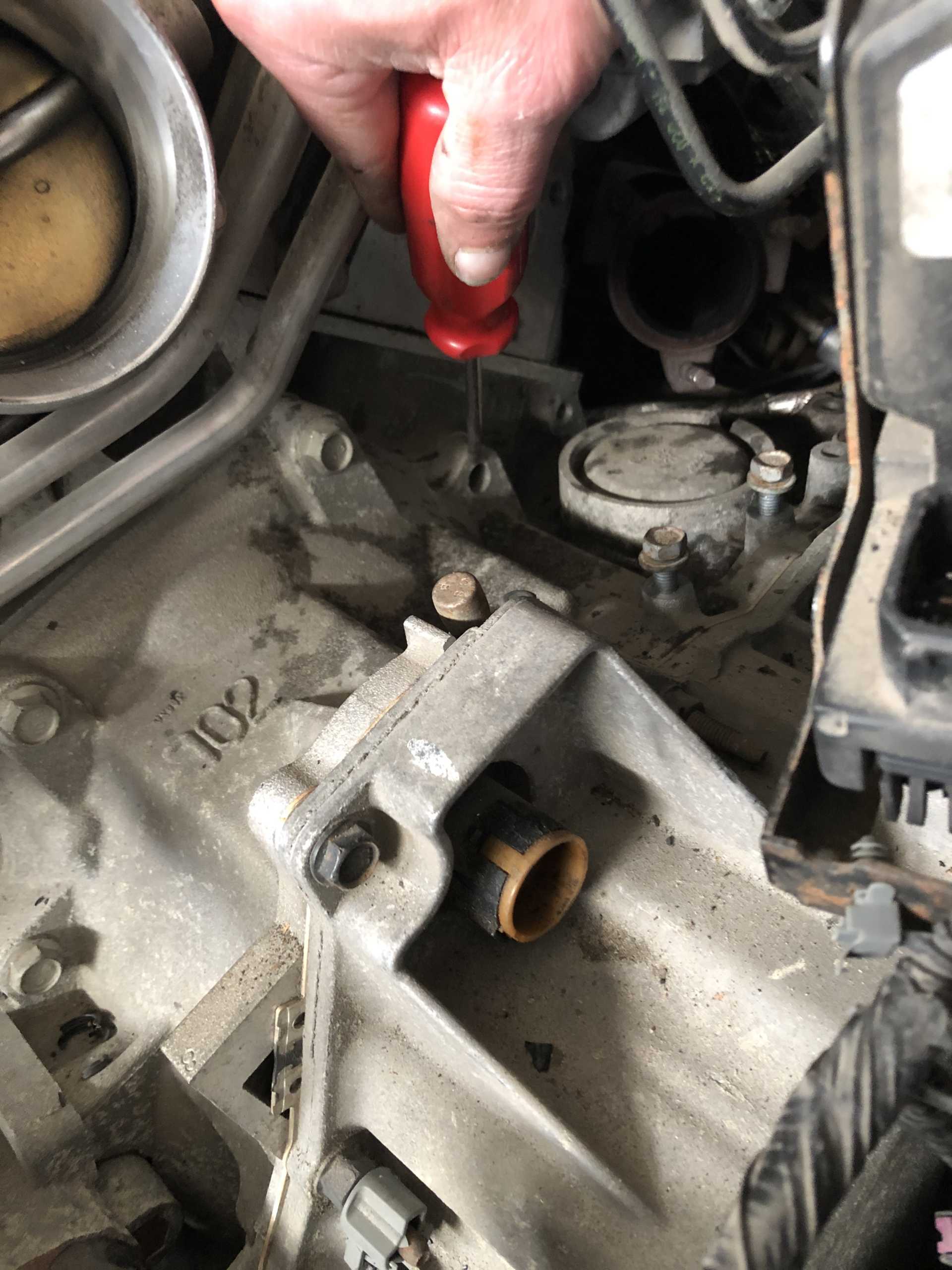

Has anyone removed the motor? That thing is stuffed in there!
I would prefer to remove just the motor since I don’t want to use the slush box (even if it wasn’t toast) and be able to easily get the rest of the car out of here as soon as possible.
A few questions: Are there just two bolts holding the starter on. I got those out and can’t find any other, but it won’t budge.
I’m only seeing one lifting point on the motor, is that it?
Where is the best place the disconnect fuel lines?
Is this a dowel pin, or is the bolt broken?

The starter only has 2 bolts, but there there are also 2 dowel pins as well. Some gentle prying up the starter will come loose.
The LS4 doesn't have a bolt in that hole, just the dowel pin.
