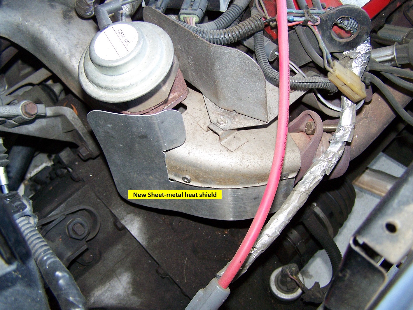

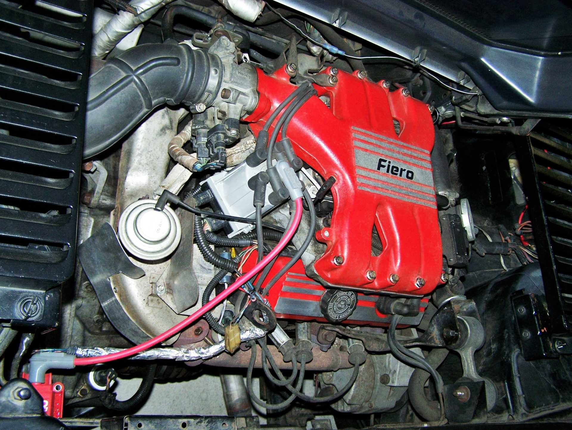

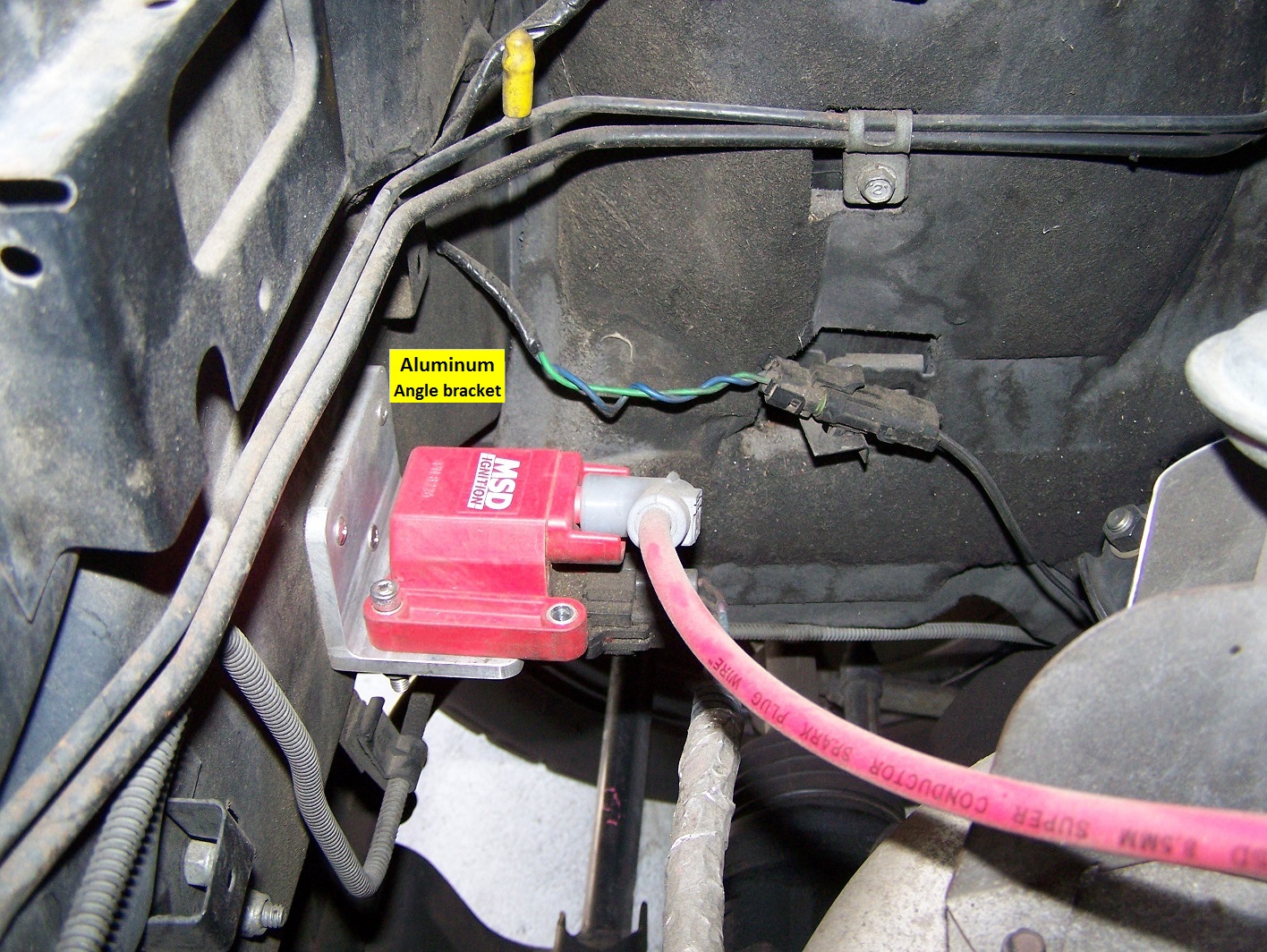

I have an MSD coil but moved it to the trunk wall....Dropped the temp from 160 to 120 (I also made an extra heat shield to block the heat of the cross-over pipe) Have had this since 2012....No trouble.
Can you tell us where you got the ignition coil plugs from? I have been wanting to do this, but I dont know where to get the right lengthed cables.
cvxjet
APR 08, 03:59 PM
The coil wire is a MSD part, 18" long....https://www.summitracing.com/parts/msd-84039
Here are some better pics of the coil mount and the heat shield....
Sorry it took a while to load the pics; It requires that I >>PREVIOUSLY<< be logged in...But when I had posted and then went to edit, it stated that I was not logged on.....Tried 3 times....Computers, they will be the DEATH of us all![This message has been edited by cvxjet (edited 04-08-2021).]
