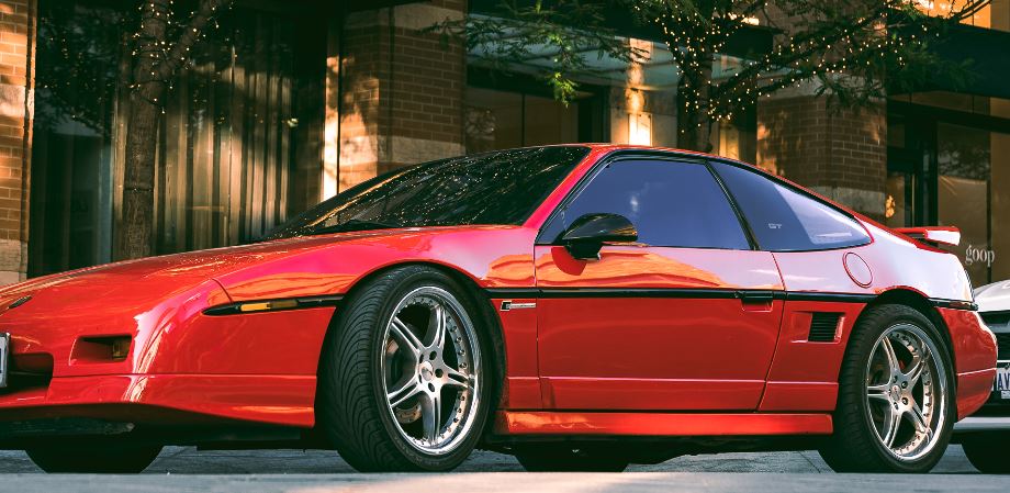

I just noticed that one of my wheels is badly damaged from running into a very deep pothole. There is no scraping that you would expect from hitting a curb, and nobody else drives my car.. (thank god, the wife and kids don't know how to drive standard
The current wheels are 18" Spyn (I don't know the model), and are quite old, so finding a matching wheel or set is likely not an option.
Any suggestions on something similar that is still available and will work on an 88 offset?

American Racing Estrella wheels are similar, with the split spokes. They have been around for a long time and probably won't be going away any time soon.

You are 100% correct Dennis. Duane (RULOOKIN) that built this car loved the bling and did a great job, but at the expense of ride quality. There was zero suspension travel in the front so I changed the springs to something with more travel. These wheels look awesome, but they are 18" , so the ultra low profile tires make for a super choppy ride. I am pretty sure that this contributed to the damage, as additional sidewalk height probably would have helped cushion the blow from the pot hole

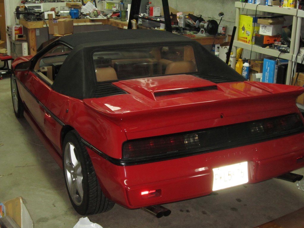

I run 17x7 38-48mm offset (depending upon which car), on the front. 215/45-17; and 17x8, 35mm offset, on the rear. 235/45-17.
For the correct offset for an 88... If I'm searching on a page like Tire Rack, I search for the 1st gen New Beetle for the rears, and Older Subaru Impreza for the fronts. Both should be 5x100. Make sure the centerbore is at least 57.1mm. Subaru-specific wheels are 56.1. (Most aftermarket are 72+mm centerbore.)
The trick will be finding the same wheels for both applications. But it can be done.
Edit - Your wheels appear to be the "Mod5". They show up on Maxim Wheels web site as discontinued. https://maximwheels.net/spyn.htm[This message has been edited by Raydar (edited 04-06-2021).]

17x7 or 17x8. 35mm offset. If you want to rotate tires, use 225/45-17s on all four. If you don't, go with 215/45-17 on the front (probably on a 7" rim), and 235/45-17 on the rear.

Will the 235/45-17 on 17x8 fit the rear of an 85 without any mods (coilovers) added?

Yes. That size on the rear of an 84.
