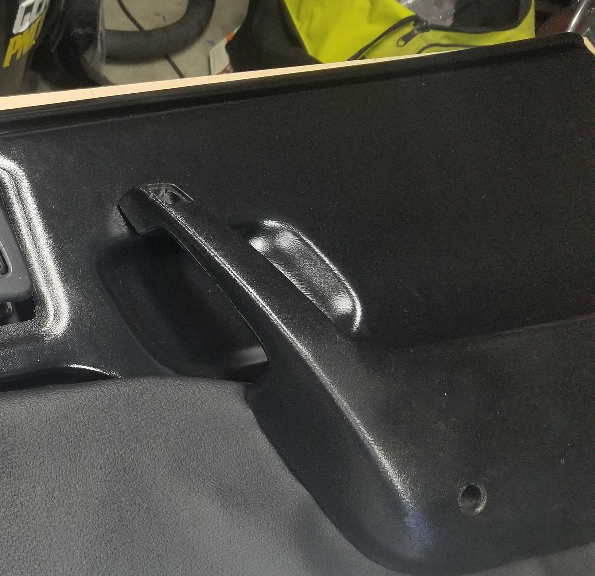

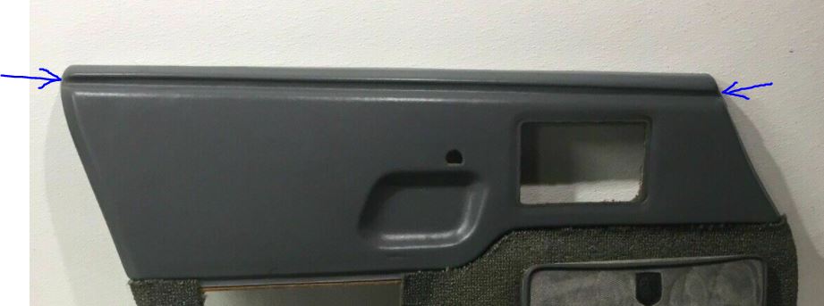

I'm in the process of changing the color of my interior to black. I'd like to upholster the top half of the door panel vs. paint.
I'll be using a black leather like vinyl but I'd like to fill in the seam on the door panel. It would make this job a bit easier.
Any suggestions?

Foam, maybe? Do you have a junk door card you can practice on?

I don't have one to practice . But while at the upholstery shop , I spoke to the owner and he suggested using 1/4 form and cover all the door panel with it. My plan was to upholster directly over the original door panel.

Maybe glue in a wooden dowel to support the foam & keep it from sinking in. Might need to grind the outer surface flat... (at least that would be ideal if you can find the right size dowel). ~ Paul aka "Tha Driver"[This message has been edited by Tha Driver (edited 03-25-2021).]

After taking a closer look at the door panels.. There were only a few areas that needed attention. I was able to fix them with super glue and baking soda. I ended up painting them black with duplicolor vinyl and fabric paint. So far I am very impressed with the outcome.
